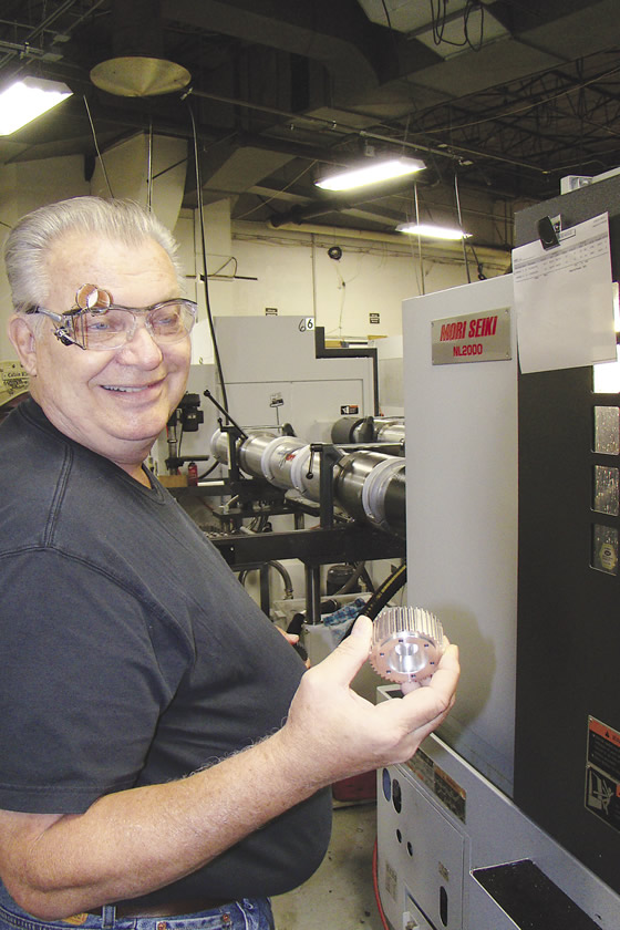

Bob Gaulrapp, shop foreman for Stock Drive Products, displays a part produced on a Mori Seiki NL2000 horizontal lathe.

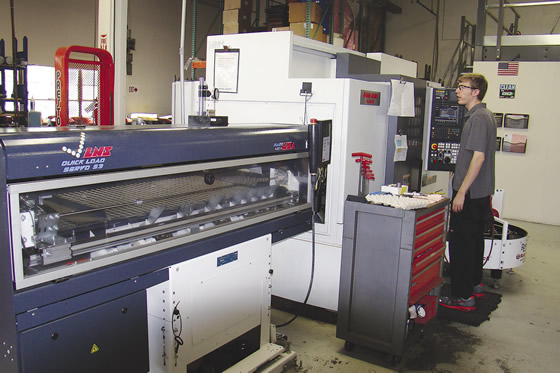

CNC machinist Jonathan Corda monitors a Mori Seiki machine tool that is integrated with an LNS bar feeder to provide long-run production.
About 5 years ago, SI purchased its first mill/turn machine, one from Mori Seiki’s original NL series. Since then, multitask machining has proven to be a beneficial addition, according to Lowe. “We were like ‘wow,’ ” he said about the company’s first mill/turn machine, “and bought a second one and said ‘wow’ again. This looks like the way our future is going.”
Lowe explained that prior to acquiring multitask technology, lathes were in one area and milling machines were across the aisle. Parts were transferred from machine to machine as needed. Now those machining tasks can be done in one setup unless the material requires heat treatment. He said: “Going forward, every possible opportunity goes through the mill/turn machine, even if it goes out for heat treating to bring up the Rockwell. We have successfully machined materials up to 64 HRC. The Mori Seiki machines are so consistent that we can hold 0.0001 ” or 0.0002 ” tolerances all day long when hard turning.”

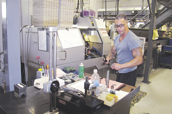

CNC machinist Damon Bahr sets up a Citizen Swiss-style machine.
In another effort to increase productivity, SDP/SI eliminated secondary operations while improving the quality of Swiss-style machined parts by acquiring updated equipment. This includes an 11-axis Star ECAS-32T Swiss-style machine, which runs three simultaneous programs and special editing software to write programs because the three programmed channels must work together.
When operating 25-year-old Swiss turning machines, SI would have to do a lot of secondary operations to finish-turn the journals, grind them, set the centers and inspect and check everything, Lowe said. “Now, we’re doing the same part with four, five, maybe six operations in one setup.”

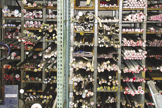

Bar stock is color-coded for easy identification, and every bar is assigned to a specific job.
