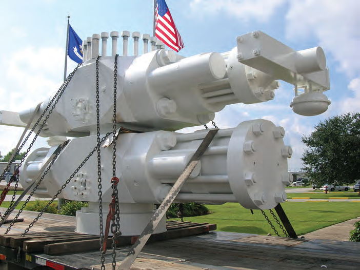

Blowout preventers contain valves with tapped holes for sealing off oil or gas.

Parts that require threaded holes include blowout preventers, Christmas tree stack-up assemblies, fracture valves, oil flanges, modules for mud pumps, valve assembly bonnets, crankshafts, riser flanges and sucker rod couplings.

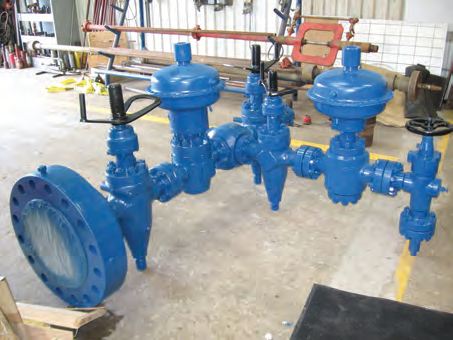

Spiral-flute taps are commonly applied in oil and gas parts, mostly for blind-holes in valves. “In the oil and gas industry, there are many wellhead parts bolted to other parts,” said Al Zaitoon, sales and marketing manager for YG-1 Tool Co., Vernon Hills, Ill. “When they get into production, (drilling companies) must have various types of valves to control flow rates of the gas or oil. These valves have a lot of flanges, which are used to connect various components.”

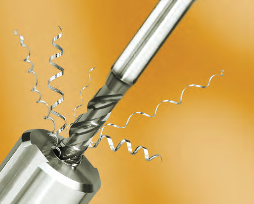

Walter Prototyp’s Paradur Inox taps with THL coating are for threading oil and gas parts.

In spiral-flute tapping, it is important to find the proper surface footage because chip formation changes with speed. “Feed rate is governed by the spindle speed and the pitch,” Hemmerling said. For example, at 20 sfm, a Walter Protoyp 1-8 Paradur Inox tap with a THL coating going 2 ” deep in 316 austenitic stainless steel runs at 75 rpm, feeds at 9.4 ipm, requires 202 ft.-lbs. of torque and uses an estimated 2.4 hp.
Terry Sebastian, CNC programmer and general foreman for Numerical Precision Inc., Crosby, Texas, uses the Paradur Inox in blind-holes for subsea and offshore equipment. “I can run them at twice the normal feed and speed and get three to four times the tool life compared to other taps I’ve used,” he said.

In the oil and gas industry, many wellhead parts are bolted to other parts.
