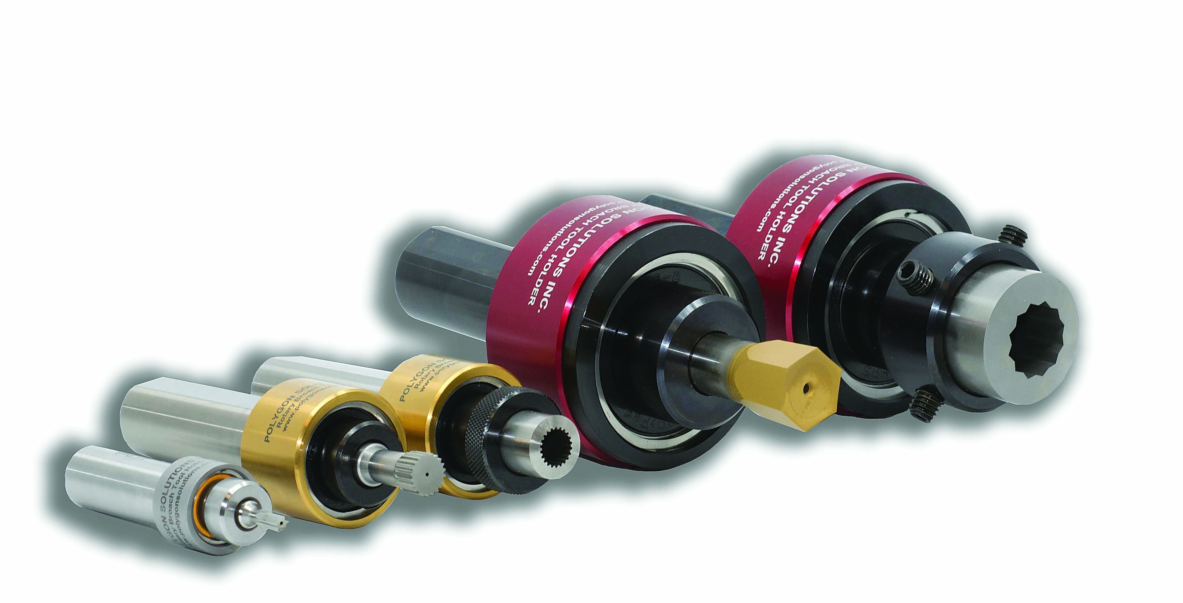

A family of broaching toolholders from Polygon Solutions. Image courtesy of Polygon Solutions

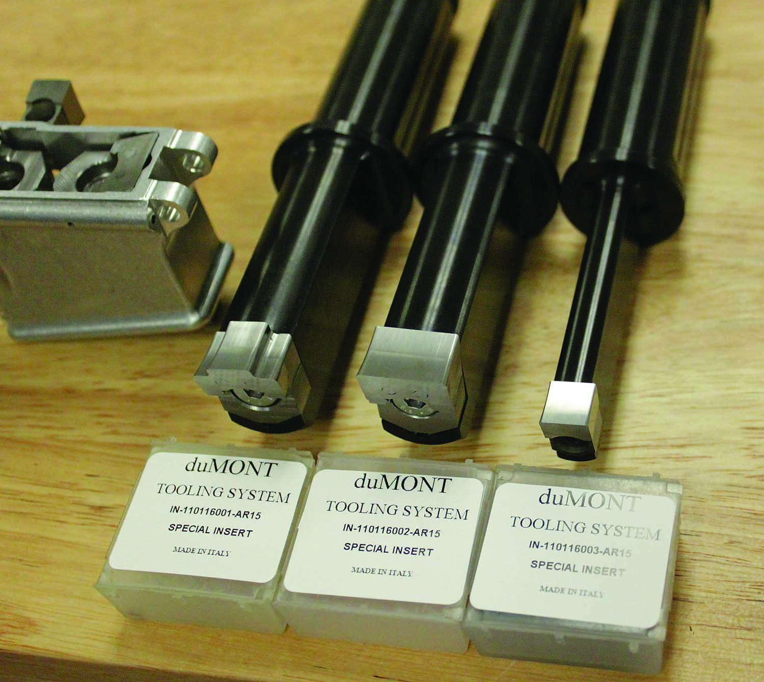

Hassay-Savage offers a slew of standard broaches in various dimensions and can create specials. In addition, the company produces kits that include the tooling and accessories for particular applications. One kit is the AR15/M16 Magwell Kit for broaching the magazine well of a gun. Instead of buying a specialized $100,000 broaching machine and an $8,000 broach—assuming that the job is big enough to justify the expense—end users purchase a $4,000 kit suitable for lower-volume work and use the kit on standard CNC machines, Wanat said.
The Magwell Kit eliminates the need for a secondary offline application. Most magwell broaching currently is done in a two-step process that requires rough milling on a CNC machine and then finishing on a vertical broaching machine. Using tools in the kit, which includes three tool bodies and three types of inserts, saves time and money by not necessitating a dedicated machine and operator.

These special inserts are for broaching magwells. The Hassay-Savage AR15/M16 Magwell Kit comes with three tool bodies, three types of inserts, two drivers and an alignment tool. Image courtesy of Hassay-Savage

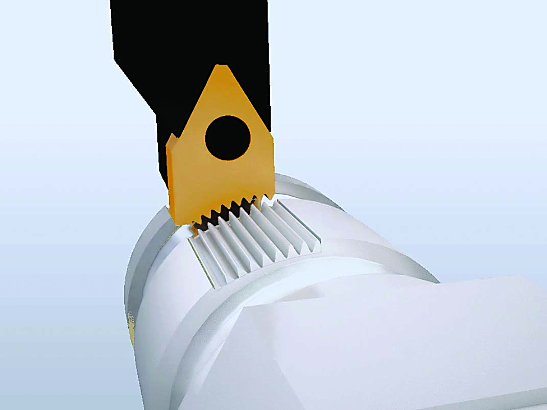

Broaching applications on CNC equipment are diverse and growing. For instance, Elgin, Illinois-based Schwanog LLC, a producer of insertable form tools, developed a broaching tool for creating serrations on turned parts using CNC equipment. In conventional machining, the production of serrations on turned parts requires a separate process. With this tool, people are able to use a new approach on a conventional lathe with a C-axis in a single operation.
The broaching tool carries a quarter-circle geometry with multiple teeth. Only the first tooth carries a complete finish-depth profile while the remaining teeth are for roughing.
Broaching the serration is a two-step operation. In the first step, the spindle does not move, and the broaching tool feeds three times until the first tooth is entirely established. During the second step, the spindle starts indexing, and the successive teeth continuously broach until the finished depth is reached.
Broaching a serration on a part's OD using Schwanog's PWP form tool system. Image courtesy of Schwanog

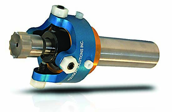

Centering and alignment also can be challenging. Rotary broaching is well suited for making small forms like hexagons and squares in soft materials, such as aluminum, brass and mild steel. However, when it comes to aligning multiple holes using a rotary broaching tool, the operation is extremely demanding, Derbin said. Most rotary broach holders have a free-turning spindle, which does not allow alignment of the holes. He said it is important to center the rotary broach as closely as possible to the middle of the workpiece. If not properly centered, users may experience oversized forms or uneven form configurations.
The rotary broach brake is a simple device used to keep a broaching spindle tight enough to hold orientation but loose enough to allow the spindle to turn while broaching. Image courtesy of Polygon Solutions
Polygon Solutions' proprietary rotary broach brake is a new mechanical solution for aligning broached forms. In addition, the company's toolholders are adjustment-free and require minimal setup.
"As long as your toolholder block on your turret or your machine spindle on your mill is centered with your workpiece by 0.0002", you can simply insert our toolholder and clamp it down," Derbin said.
