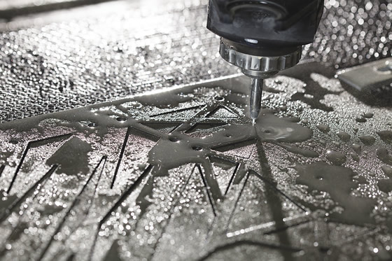

What has changed is the ease of programming and operating an abrasive waterjet machine, according to Burnham. This enables someone with average rather than advanced skill to set up and cut a workpiece.
Nonetheless, to take advantage of a waterjet’s inherent versatility, high-end systems have advanced controls and built-in knowledge to take the guesswork out of waterjet programming and operation. “The programmer enters the pattern, material type, material thickness and desired quality level, and the machine knows how to select the right speeds and lead-ins and lead-outs without needing a series of test cuts,” Burnham said. “The easier the programming the better, since finding great programmers gets tougher and tougher.”

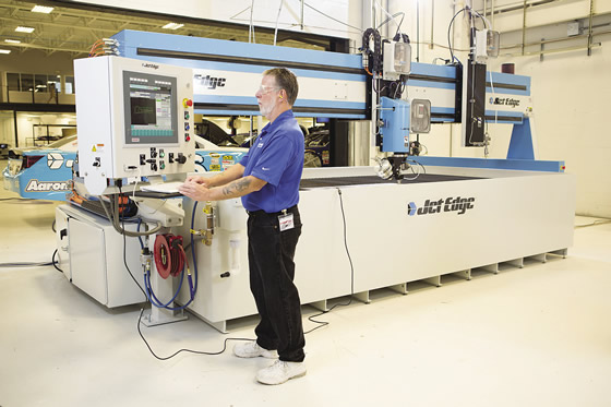

Process software plays a key role in transferring the knowledge a waterjet machine tool builder has acquired to end users—especially new ones, added Jeff Schibley, Midwest regional manager for St. Michael, Minn.-based Jet Edge Inc. “Regardless of whether you processed 1 “-thick steel in the past, the software instructs the machine that these are the parameters it will operate at and create this quality,” he said. “Now, the customer doesn’t have to have knowledge of abrasive waterjetting to run that machine.”
EDGE%20X-5%20cutting%20close%20up.tif
An EDGE X-5 5-axis waterjet system from Jet Edge can produce complex contours. Image courtesy Jet Edge.

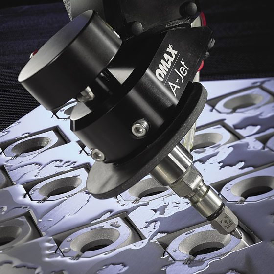

The A-Jet from OMAX is a software-controlled, multiple-axis cutting head that expands the versatility of a waterjet machine by being able to produce a variety of features, such as beveled edges, angled sides and countersinks. Image courtesy OMAX.
Ruppenthal added that having the ability to raise and lower the water level and enable cutting underwater is another recent addition to the standard entry-level line. Cutting underwater increases workplace hygiene by keeping the shop cleaner and reducing worker fatigue, according to Ruppenthal. “The quieter the machine is, the less it affects the person standing around or near it all day long.”
In addition, a company that purchases either brand of machine can have 5-axis capability. Besides being able to remove taper, Ruppenthal noted that capability enables producing a part with complex contours, such as a turbine blade, and generating helpful features, such as a weld-prep bevel. “If you’re a job shop, it opens up business opportunities that you didn’t have before.”

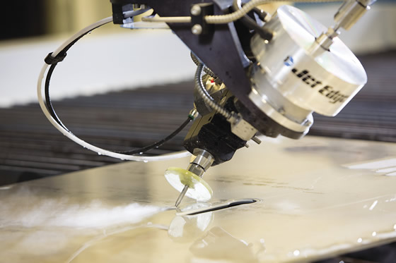

Another factor when deciding on a waterjet machine is pump pressure. The higher the pressure, the higher the productivity, because higher pressure is inherently more efficient, according to Burnham.
Waterjet machines use two types of pumps: rotary direct drive and linear intensifier. The design of a direct-drive pump enables it to deliver pressures up to 60,000 psi (4,137 bar), while an intensifier pump tops out at more than 90,000 psi (6,205 bar). Flow offers both varieties, including the Hyplex Prime direct-drive pump (55,000 psi, or 3,792 bar) and the HyperJet intensifier pump (94,000 psi, or 6,481 bar).
“We will typically advise customers that the best way to get productivity and ease of use is to take the pressure up and cut faster with one head than trying to put multiple heads on,” Burnham said.
He added that, while intensifiers have longer maintenance intervals and are better suited for applications where the cutting head will have a lot of on/off cycles, direct drives are smaller and more electrically efficient. About 80 percent of the installed waterjets have intensifier pumps.

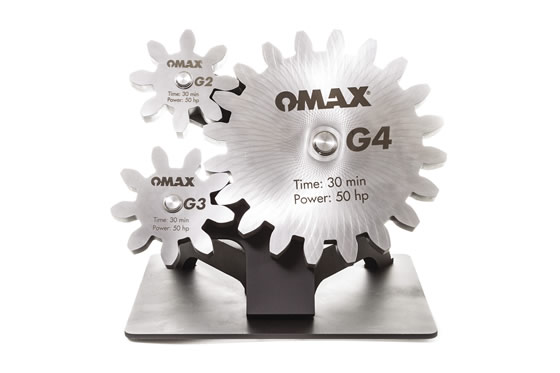

The only difference in the production of these three gears was the OMAX software that was used to control the jet, with the second-generation software for G2, the third-generation software for G3 and the latest, fourth-generation software for G4. Image courtesy OMAX.
To illustrate the company’s ability to do that with the assistance of its software that controls the jet, the OMAX exhibit at this year’s EASTEC trade show included a display with three gears. Ruppenthal explained that one gear was marked G2 for the company’s second generation cutting model, the G3 gear was larger and represented the third generation model, and the G4 gear was drastically larger than the others and showcased the new fourth generation cutting model. “The only difference between the sizes of those gears is the software, the way we control the jet,” he said. “They were cut in the same amount of time and with the same amount of abrasive and the same amount of horsepower. The latest software version allows dramatically faster cutting.”

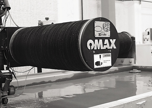

Smalley Steel Ring Co. has donated an OMAX 2652 abrasive waterjet machining center to the College of Lake County. Headquartered in nearby Lake Zurich, Ill., Smalley manufactures retaining rings and wave springs. The waterjet machine is the college’s first and reportedly broadens its CNC/machine tool trade department’s ability to offer the waterjet technology skills sought by many employers recruiting CLC graduates, including Smalley. The cantilever-style machine has a 5 ‘9 “×2 ‘6 ” (1.75m × 0.76m) table and can achieve tolerances as tight as ±0.001 ” (±0.025mm).
OMAX%202652%20JetMachining%20Center%20from%20Smalley%20Steel%20Ring.tif
To help students learn about waterjet technology, Smalley Steel Ring donated an OMAX 2652 abrasive waterjet machine to the College of Lake County. Image courtesy OMAX.
