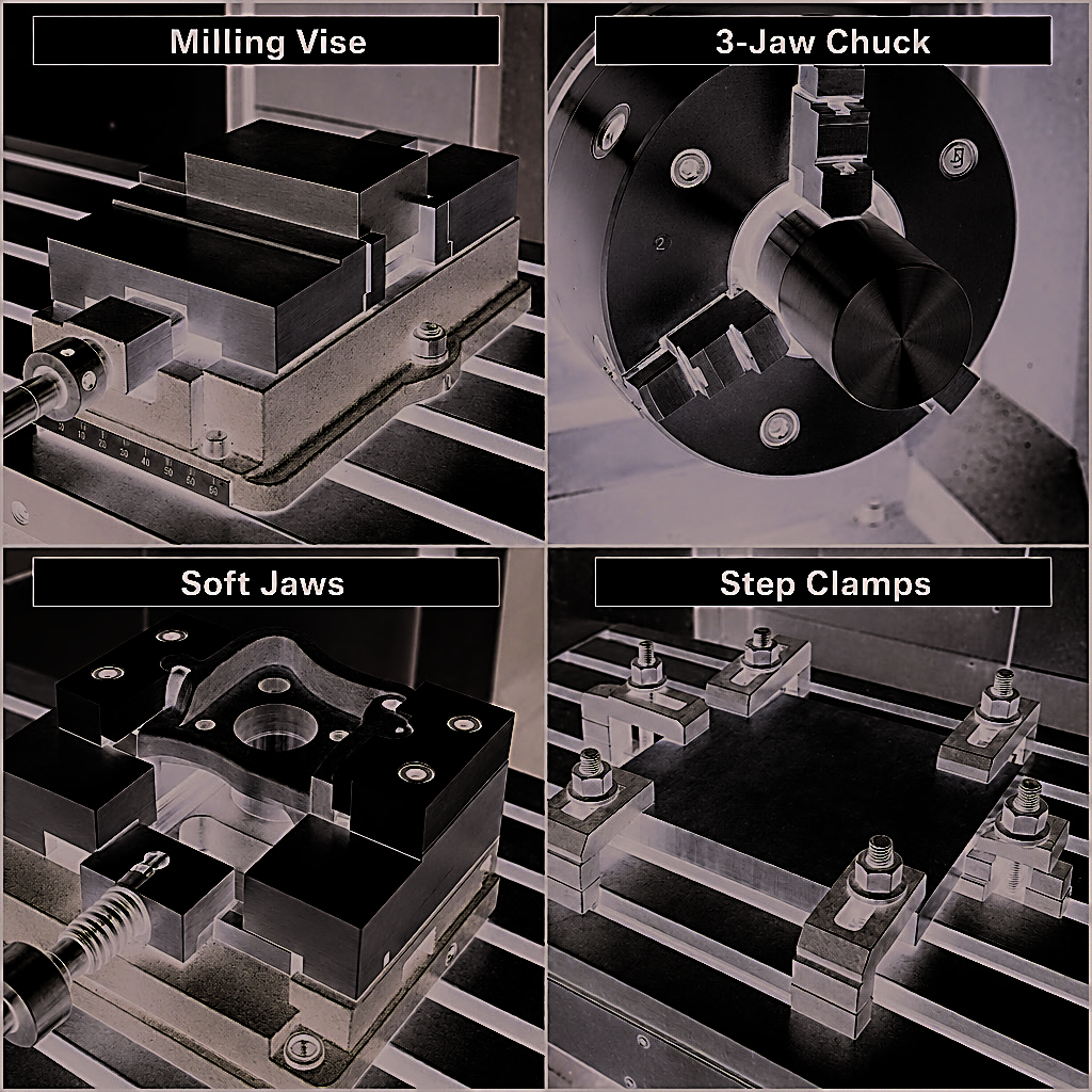

For most prismatic (block-shaped) parts, the milling vise remains the industry workhorse. Its popularity comes from its simplicity and strength. However, it requires a part to have at least two parallel sides. To achieve precision and gripping force with a vise, the workpiece should have adequate flatness and parallelism. The vise should also be precisely aligned with the machine axis.
When parts have an are irregular contour, soft jaws typically made from aluminum or plastic can be machined to match the exact profile of a workpiece. The soft material ensures that the grip on finished surfaces does not damage the part.
For cylindrical workpieces, a three-jaw chuck or a collet chuck will provide a simple and effective solution.
When a workpiece exceeds the physical capacity of a standard vise or features a complex geometry, step clamps (and their cousins, toe clamps) become essential because they secure the material directly to the machine’s table via T-slots. Though very flexible, this method has some drawbacks. Setup takes longer and repeatability is lower when changing workpieces compared to modular or zero-point workholding systems. Clamps also demand greater skill and experience from a machinist.

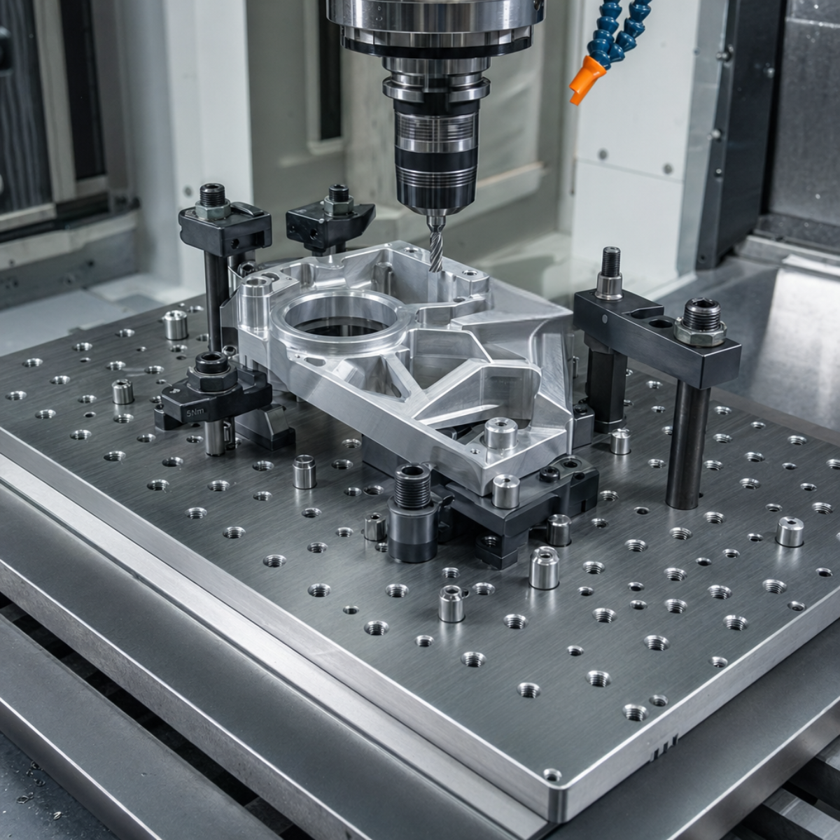

As shops move from one-off jobs to medium-volume production, setup time becomes a profit killer. This is where fixture sub-plates (tooling plates) and modular fixturing come into play. These plates feature a precise grid of holes for dowel pins and fasteners, enabling high repeatability and lots of flexibility.
The easiest and fastest way to clamp parts with high repeatability is by using a zero-point clamping system. These systems use a special plate with a precision “quick-change” mechanism attached to the machine’s table, paired with a matching vise or other fixture. A workpiece can be taken out for measurement and returned instantly to the exact same location. Alternatively, you can use a second zero-point clamp to change workpieces quickly and accurately.
A zero-point clamping system offers the easiest and fastest way to clamp parts with high repeatability because fixtures can be swapped in seconds, positional accuracy is typically guaranteed to within 0.2" and spindle downtime is virtually eliminated. Machinists can prepare the next job on a separate pallet while the machine is running.

Clean the table. Before placing any fixture on a machine table, ensure the surface is clean and free of chips. Even a tiny piece of swarf caught between a fixture and the workpiece can cause a scraped part. A light coat of rust-preventative oil is recommended if a fixture will remain on the table for an extended period.
Torque to spec. Always verify that clamps and fasteners are torqued to a specified value. Over-tightening can distort a workpiece or damage fixture components, while under-tightening risks movement during a cut. A calibrated torque wrench should be part of a professional setup.
Check for wear. Check datum surfaces and locating pins for wear on a regular basis. You don’t want a worn locating pin introducing a positional error that can be difficult to trace or mistaken for a machine problem. Replace any component showing visible wear before it affects part quality.
Record fixture orientation. When removing a fixture from the machine, mark its orientation before. Reinstalling a fixture in the wrong orientation is a common and avoidable mistake, particularly on fixtures that look the same from multiple angles.
