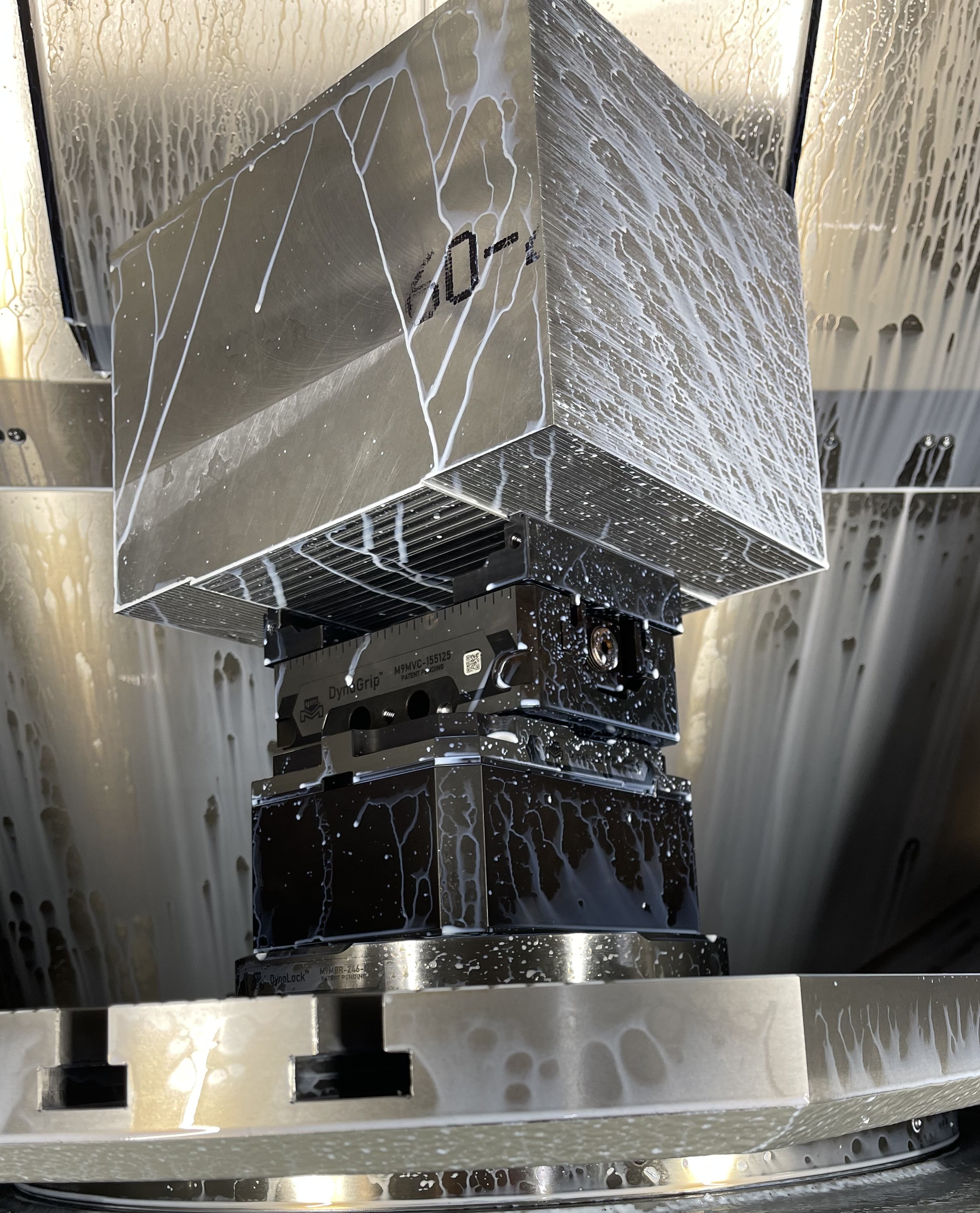

Mate DynoGrip self-centering vise holding a large workpiece
Premium workholding, such as Mate’s DynoGrip™ self-centering vise, provide maximum clamping force, which is critical to maintaining a rigid and reliable workholding setup. Credit: Mate Precision Technologies

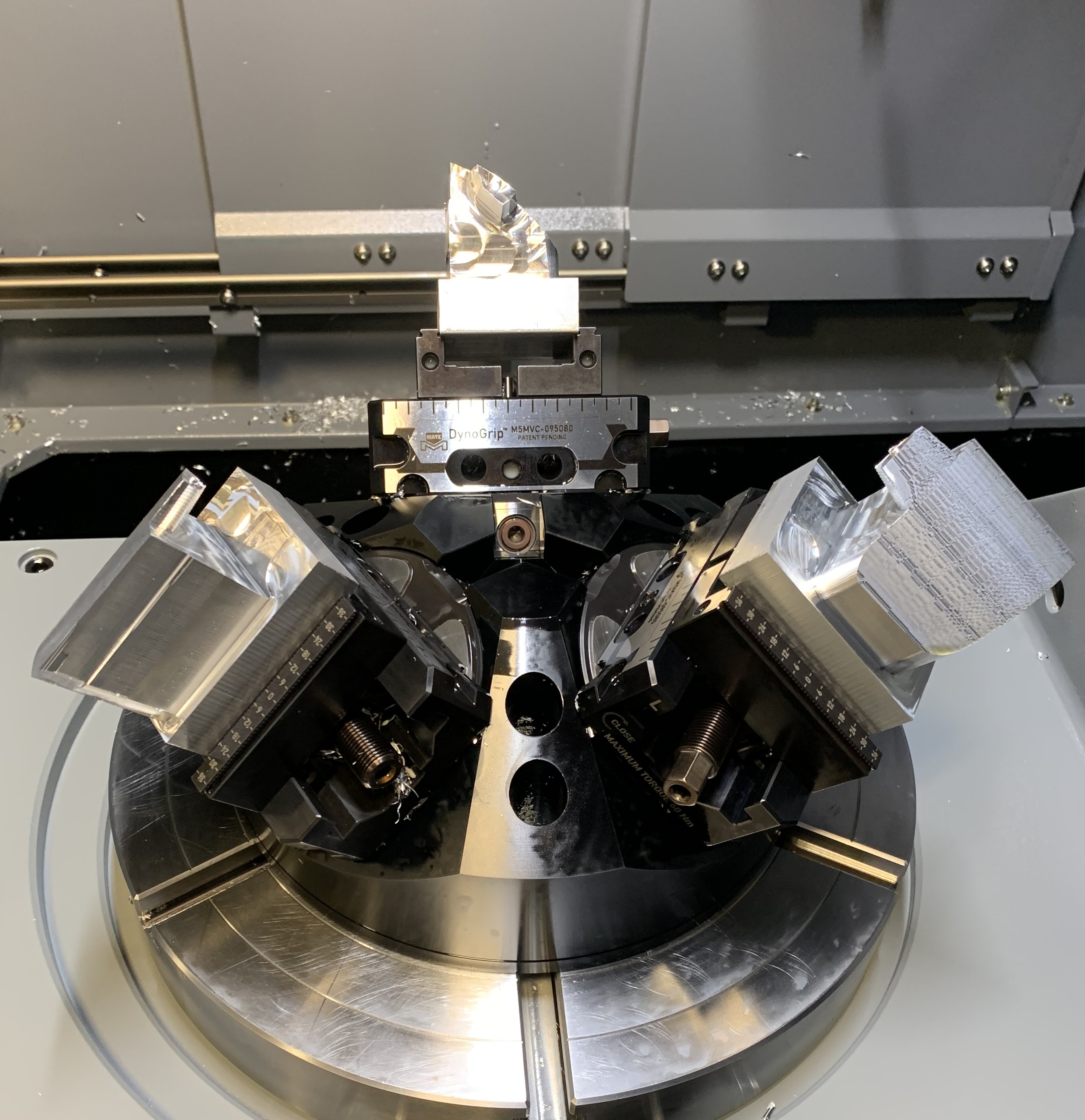

Mate DynoMount pyramid workholding setup
A modular workholding system, such as Mate’s DynoMount pyramids, maximize cutting tool access, increase fixture density and increase overall productivity. Credit: Mate Precision Technologies
