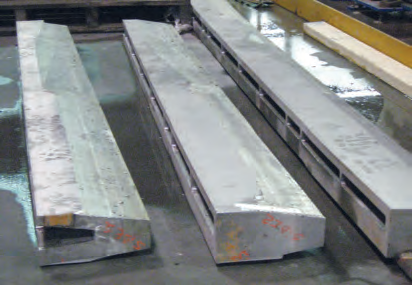

Wolverine Machine Products Co., Holly, Mich., has manufactured screw machine products for the automotive industry for more than 85 years, but also has diversified into CNC machining and waterjet cutting. One of the shop’s two waterjet machines is a WardJet RX-3013 with a 156 “×360 “×10 ” work envelope. The machine’s large capacity and Wolverine’s ability to work through challenges and apply innovative solutions landed the shop a job cutting a 50 “-wide × 108 “-long × 7¼ “-thick Invar 36 plate into 18 different rail-like pieces for tooling to form carbon fiber into a wing component for a jet.
Courtesy of Wolverine Machine Products
Wolverine Machine Products employed waterjet technology to cut a 7¼ “-thick, 9,000-lb. Invar 36 workpiece into 18 different rail-like parts.

Because no two parts were the same, the shop used only one of the four cutting heads on the RX-3013 machine. The speed of the water and abrasive stream is basically constant, but Walker noted Wolverine had control over how fast the stream was feeding through the material. The feed rate was 0.25 to 0.9 ipm.
Walker cut the part with crushed 50-grit abrasive, a coarse garnet. The crushed material’s sharp edges are more aggressive when cutting through thicker material. “Generally, we use a 0.014 “-dia. orifice and a 0.040 “-dia. nozzle. That seems to work unless you are doing something extreme,” he said.
Tolerances were not tight. “We put ±0.060 ” on the quote, and that’s pretty wide open for us,” Walker said. “They left ¼ ” of stock for subsequent machining. So as long as we didn’t eat into their ¼ “, they were happy.”

Waterjet cutting consumed 80 hours, with each of the longer parts taking up to 8 hours to cut.
