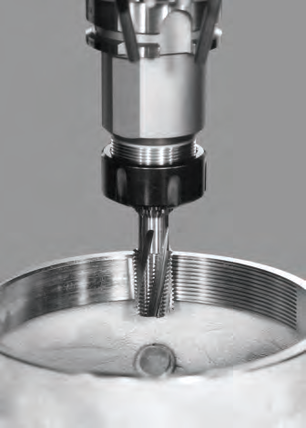

A GFM thread mill from JBO-USA threads a large-diameter component.
With the right tools, thread milling large bore diameters doesn’t have to be daunting.
When a hole requires threads, part manufacturers basically can perform conventional tapping, cold-form tapping or thread milling. When it’s a large hole, meaning 1 ” to 1½ ” in diameter and larger or a taper pipe, thread milling is preferred. Partly, that’s because the total cost for applying taps for larger threadmaking applications can be higher than thread milling. For example, larger taps can cost $150 or more, according to Joe Mazzenga, owner of JBO-USA, Troy, Mich. He added that although a thread mill costs more initially—$250 to $350 apiece—it’s able to achieve higher productivity, making the thread mill more economical.

Tapping is a common way to produce an internal thread, but that doesn’t necessarily make it the best method. “Taps become less of an advantage even in small diameters,” said Duane Drape, national sales manager for HORN USA Inc., Franklin, Tenn.
Because a thread mill cuts a thread using helical interpolation on a CNC machine with three simultaneous axes, the tool is smaller than the diameter of the hole being threaded. Therefore, if a thread mill does happen to break when threading, it doesn’t get stuck in the part and can be easily removed. “It definitely reduces rework costs,” said Rob Brown, product manager for Allied Machine & Engineering Corp., Dover, Ohio. “With a broken tap, you would have to burn the tap out and, a lot of the time, you have a significant amount of rework or you scrap the part.”
Not engaging all sides of a hole like a tap allows freer machining when thread milling. This reduces machine tool horsepower requirements while boosting productivity.

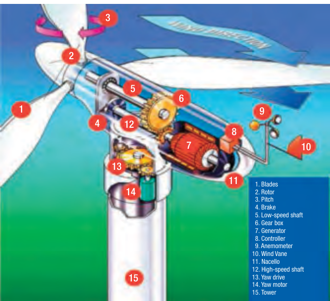

An end user initially applied taps to manufacture an internal thread for a 59.6 “×11 “×65 ” wind turbine body, but average tap life was 250 threads and the surface finish was poor. In addition, tools often broke inside the workpiece material. After switching to MiTM25 thread mills from Vargus, tool life reportedly increased to 1,500 threads per cutting edge with a fine surface finish, and machining time was reduced by 25 percent.
