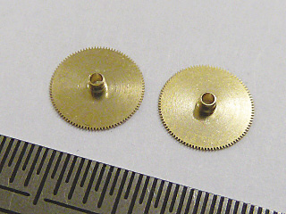

The Fralsen, France, company makes watch movements via three technologies: plastic injection molding of small parts with fine details, cutting and coiling of complex springs, and turning, hobbing and otherwise machining parts, such as wheels, pinions, arbors and rivets. Tolerances are as tight as 15µm for concentricity and 10µm for center-to-center spacings and distances.

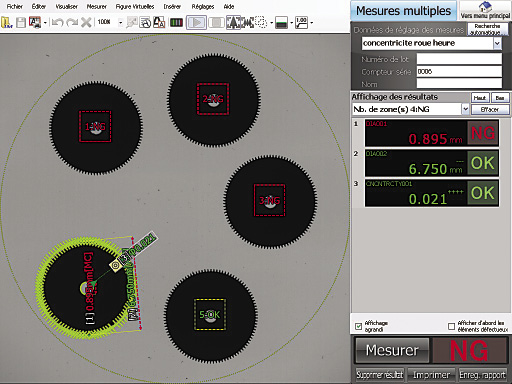

The Keyence IM-6500 series image dimension measurement system displays green for good parts and red for bad parts, such as these metal wheels (below).

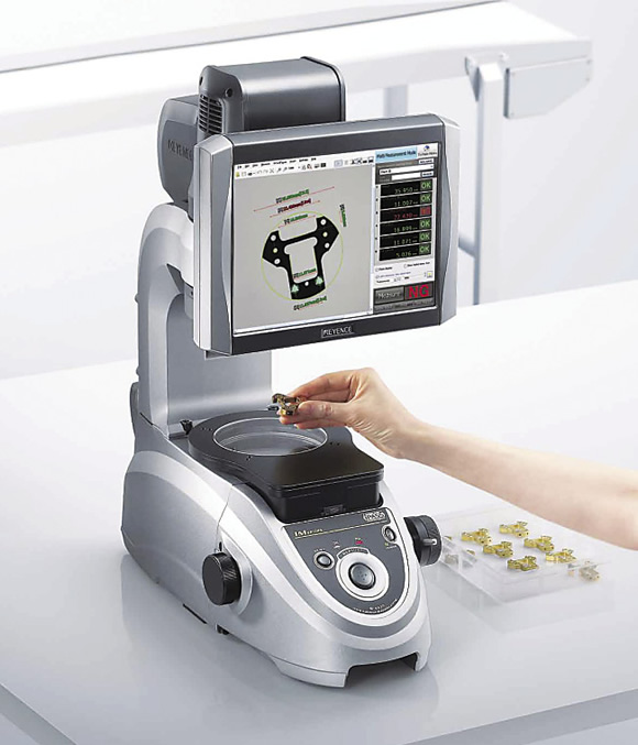

Seeking a solution, Fralsen-Timex examined a number of other AIS machines and was impressed with the IM-6500 series image dimension measurement system from Osaka, Japan-headquartered Keyence Corp. after reading about the system in a Keyence newsletter and seeing it at a trade show. (Keyence Corp. of America is based in Itasca, Ill.) The Keyence system is “quite singular” because of its user-friendly interface, Scotto pointed out, adding that QC personnel and production operators can use it. “The IM series eliminates variations in interpretation of measurements.”
Courtesy of Keyence
The IM series image dimension measurement system enables part manufacturers to quickly and simply perform part inspection, according to Keyence.
The system displays measurement results in green for “OK” and red for “no good” and allows users to simultaneously measure multiple identical parts. The size of the parts and the number of elements making up the program are the only limits, according to Keyence. Up to 99 points can be measured with a repeatability of ±1µm.
In addition, users can save the results, track statistics and compare part profiles against master profiles imported from CAD files. “As a result, we no longer need to position templates on parts and measure differences in shape by eye,” Scotto said. “The machine does it automatically and extracts an image of the contour, showing the difference with the tolerance.”
With the Keyence system, Fralsen- Timex saves a significant amount of time when measuring parts. Compared to measuring the concentricity of 25 hour-second wheels in 15 minutes using conventional inspection equipment, for instance, the parts manufacturer measures them in 3 minutes with the Keyence system. In other applications, it took 3 minutes to conventionally measure the general dimensions of three stators vs. 2 minutes to measure six stators on the new system, 2 minutes to conventionally measure the concentricity of two wheel correctors vs. 3 minutes to measure 10, and 15 minutes to inspect the center-to-center spacing on one plate vs. 3 minutes to inspect two plates on the Keyence.
