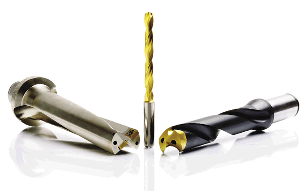

Drills with tungsten-carbide cutting edges enhance holemaking productivity. The choice among (from left) indexable-insert, solid-carbide or interchangeable-tip drills, like these perfoMax, feedMax and Crownloc drills from Seco Tools, depends on the user’s requirements for speed, accuracy and economy.
Sandrud noted that indexable-drill design influences hole accuracy because the tool’s overlapping indexable inserts form an asymmetric drill point. “You need a balance of the tangential forces between the periphery and the center insert to minimize drill deflection at the entrance to the hole,” he said. Balancing those forces can produce close hole tolerances, even though indexable drilling is considered a roughing operation. On the other hand, the two cutting edges of an interchangeable-tip drill are symmetric and it is “more of a semifinishing and a finishing tool due to the tolerance we can make with the drill,” he said.
Accuracy and hole geometry depend on many factors, including the drill length, machining conditions and workpiece material. However, Sandrud said, under normal conditions Seco Tools’ feedMax solid-carbide drills might typically produce a 40µin. Ra finish with a positioning accuracy of 0.0008 “, while its Crownloc interchangeable-tip drills can produce finishes of 64µin. Ra with a positioning accuracy of 0.002 “.
Interchangeable-tip drills offer accuracy on a par with solid-carbide tools, according to Rich Maton, assistant engineering manager for Sumitomo Electric Carbide Inc., Mount Prospect, Ill. Compared to the typical ±0.005 ” accuracy of an indexable-insert drill, an interchangeable-tip drill like the company’s SMD tools can hold ±0.002 ” in most cases, compared to the ±0.001 ” typical with solid-carbide tools.
The steel drill body of an interchangeable-tip drill is somewhat less rigid than the body of an equivalent solid-carbide drill. Bob Jennings, product manager in the holemaking group at Ingersoll Cutting Tools, Rockford, Ill., said that situation may actually represent the best of both worlds: a tool that offers the wear resistance and productivity advantages of a solid-carbide tool and is “in some ways more forgiving of misalignment.” Typical examples of misalignment include cases where “fixturing is not the best, the workpiece itself lacks rigidity or there’s some runout in the spindle,” he said. If alignment is not true, hard and rigid solid-carbide drills can break or chip. In the case of an interchangeable-tip tool, misalignment or runout may compromise the dimensional accuracy of the hole, “but you are not going to break the tool,” Jennings said.

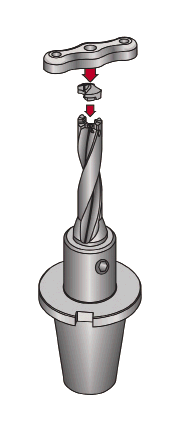

Clamping methods for interchangeable-tip drilling systems range from internal or external screws to turn-and-click systems like the Qwik-Twist (pictured) from Ingersoll Cutting Tools.

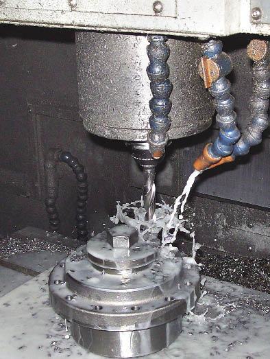

At Peoria, Ill., shop Quality Metal Products, a 17mm-dia. GEN3SYS interchangeable-tip drill from Allied Machine & Engineering produces a 4.5 “-deep through-hole in 1E0018 gray iron at a cutting speed of 1,400 rpm and a 15-ipm feed rate.
Interchangeable-tip drills, Stevens said, are less expensive than solid-carbide ones. A 15mm- to 20mm-dia., solid-carbide drill for making holes 7 diameters deep costs about $600, while a GEN3SYS tool for making the same holes costs about $250 for the body and $75 to $90 for the inserts, he said.
Quality Metal Products Inc., Peoria, Ill., produces elbows, brackets and adapters made of steel and ductile and gray cast iron. Rob Lemons and Tim Swise, who purchase tools and oversee operations for the shop’s CNC machines, said much of the facility’s drilling requires drills in diameters up to 1.5 ” to make holes 10 diameters deep. They use the GEN3SYS drills because “We need long tool lengths,” Lemons said, and solid-carbide drills that long cost “a fortune.” The interchangeable-tip tools are “cheaper to start with, we are getting better tool life and we have increased our speeds and feeds,” he said. According to Swise, the interchangeability enables the shop to “replace the whole tip in a couple seconds,” without a need to reset tool offset because the new tips always match the original length recorded in the machine program. Finally, interchangeable-tip tools are preferable to those that require resharpening, which in a production environment “require you to have a lot of tools in the pipeline. Because whatever you’ve got out in resharp, you still have to have plenty on the shop floor,” Swise said.

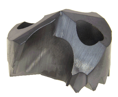

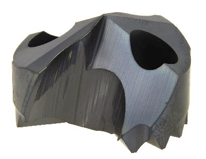

Interchangeable-tip drill geometries can be designed to maximize productivity in specific workpiece materials. For example, an MTL-style tip (top) from Sumitomo for its SMD drills is for general-purpose applications. An MEL-geometry tool (bottom), conversely, has a sharper cutting edge designed to be freer cutting in exotic alloys.
Interchangeable-tip drills provide a further degree of flexibility in that the bodies can be fitted with tip geometries that maximize productivity for a specific workpiece material. For example, among the specialized geometries offered by Sumitomo for its SMD tools are MTL-style tips for steels and general-purpose applications, and MEL-geometry tools that are freer cutting in workpieces like stainless steel and high-temperature alloys.
The MTL configuration features a hard, wear-resistant substrate and a cutting edge with a 0.003 ” to 0.005 ” T-land edge preparation (varying in relation to drill diameter) for strength. On the other hand, the MEL tool tip has a sharper cutting edge to shear exotic alloys, but its substrate is tougher than that of the MTL tool to resist edge fracture.
The MEL tips also have a back taper of 0.010 “/in. compared to the 0.003 “/in. to 0.004 “/in. back taper of MTL tips. “Exotic materials tend to swell while being drilled, and with more back taper it gives it a nicer finish and you don’t have withdrawal marks when you take the drill out of the hole,” Maton explained.

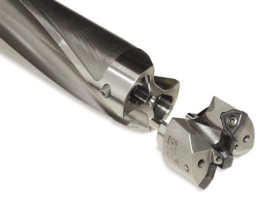

The KSEM PLUS drill style from Kennametal is a hybrid of indexable-insert and interchangeable-tip drill technologies.
Hybrid tool for high-volume jobs
In Spring 2009, Kennametal introduced a line of interchangeable-tip tools that can be considered a hybrid indexable-insert/interchangeable-tip drill technology. Like an interchangeable-tip drill, KSEM-PLUS tools have a steel body with a detachable cutting head. The head, however, is made of steel and holds a centrally located, two-edged KSEMP tip like that on Kennametal’s KSEM interchangeable-tip drills. Flanking that tip are two DFT D indexable trigon inserts, which effectively extend the length of the drill’s cutting edges and drill larger-diameter holes. According to Kennametal, the central tip provides high feed rates and centering capability, while the inserts on the periphery facilitate chip control and higher cutting speeds. As a result, the drills can achieve higher cutting speeds than other interchangeable-tip tools while offering similar feed capabilities, according to Kennametal.
The KSEM PLUS drills produce hole diameters from 1.250 ” to 2.756 “. On the higher side of that range, the combination of a KSEM tip and trigon inserts is more economical than a large interchangeable carbide tip. The outer inserts are indexable, reducing tool costs and maintaining the ability to perform quick changes with the tool in the machine spindle. The heads are coupled to the drill body via a “flexible drilling system” that uses two angled, radially activated locking screws. Chet Parzick of Kennametal said the concept for the KSEM Plus system originated in the heat exchanger industry, where productivity and economy in high-volume hole production is crucial.
