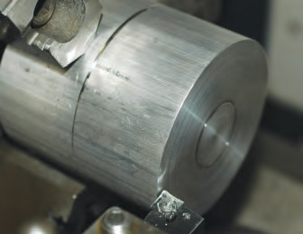

• Put target score marks on raw material for fast roughing. Touch off the tool and use a scale to make reference marks so you can reduce measuring time. Rip and tear down close to the lines and then pull out your finer measuring tools.

Put score marks on raw material for fast roughing.
