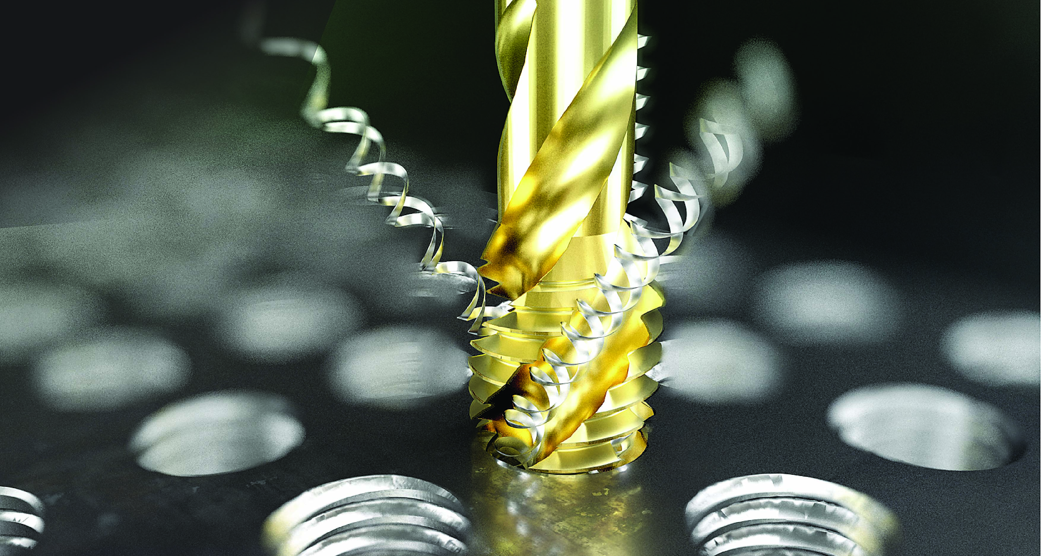

YG-1 Tool (USA) recently came out with a line of taps for high-volume, repetitive manufacturing operations looking for productivity gains. Called Synchro Taps, they can run roughly two to three times faster than conventional taps, Ford said. This is possible, he said, because the new taps are extremely free cutting — that is, designed for minimal contact with the part, which reduces cutting forces and heat. Additionally, the company controls runout features very tightly during the tap manufacturing process.
“We hold pitch diameter, OD and chamfer runout to within a few microns, whereas (applicable) standards allow tolerances of as much as 0.0015″ (0.0381 mm) when grinding these features,” he said. “By doing that, we can run the tap at extreme speeds.”
YG-1 Tool (USA) also holds a tolerance for the tap’s shank diameter that’s much tighter than normal — the same shank tolerance that commonly would be used for a carbide drill or endmill.
“That allows us to increase the pitch diameter of the tap ever so slightly,” Ford said, “but enough to add more tool life.”

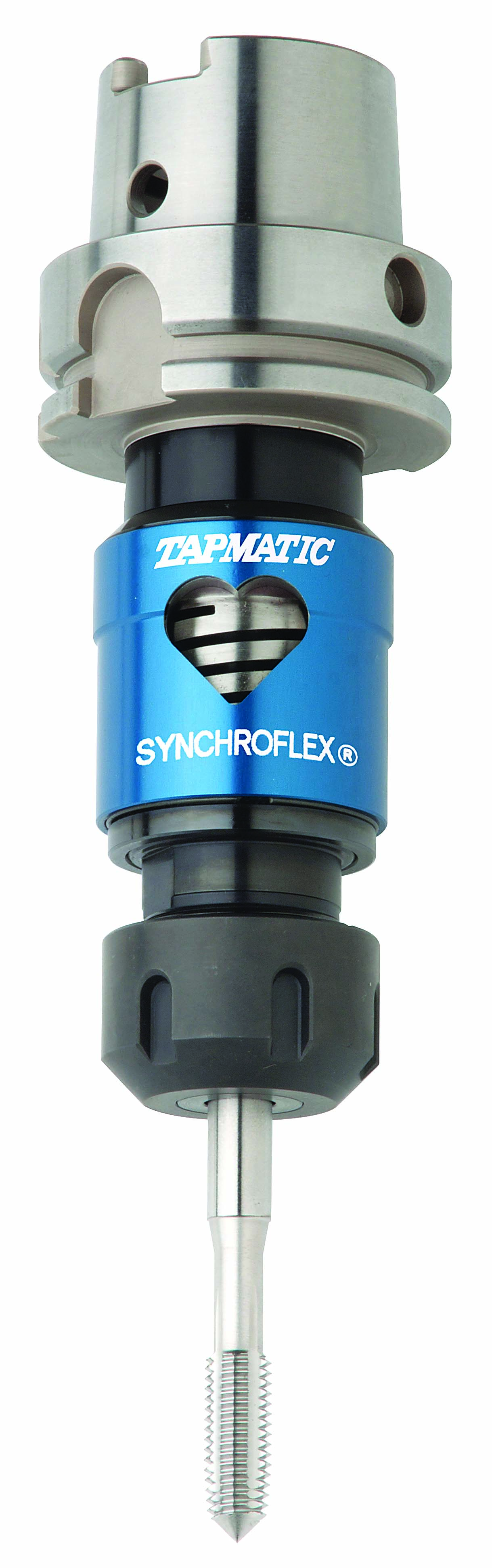

Although a totally rigid holder has a number of advantages over a floating holder, there’s also a downside: Unlike a floating holder, a rigid one doesn’t compensate for force applied to a tap during a rigid tapping cycle. This force stems from the fact that there is always a small discrepancy between the tap lead programmed into the machine controller and the lead actually ground into the tap. But there’s no give in a totally rigid holder to mitigate the effects of this discrepancy. As a result, Johnson said, a heavy thrust load is applied to the tap, which makes it wear more quickly and can adversely affect thread quality.
So for those using a synchronous machine for tapping, Ford recommends the use of a synchronous-style holder, such as his company’s Synchro Chuck. Inside these holders are objects like springs, washers and rubber gaskets, which allow a very small amount of movement — far less than that permitted by a floating holder but enough to absorb forces generated by rapid stopping and reversing while rigid tapping. He said this can yield as much as 25% more tool life and improved thread finish compared with tapping done by completely rigid holders. Some also believe that synchronous holders allow slightly faster spindle speeds during the tapping process, he said.
Inside the SynchroFlex synchronous holder from Tapmatic, the force-absorbing mechanism is a precision flexure like a machine spring. Johnson said the small amount of give provided by the flexure makes a big difference in tool life.
“You typically get double the tap life compared to a solid holder,” he said.
