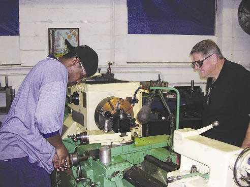

Jerome Green (left), an apprentice at Chesapeake Machine Co., chases Acme threads with Instructor Garry Mathias.
Rustkelis: It depends on our workload. If it’s light, then the apprentices spend some time with the machinists. They start on a Bridgeport, then move up to lathes and other machines. If work is available, we urge them to use what they’ve learned and make a product.
