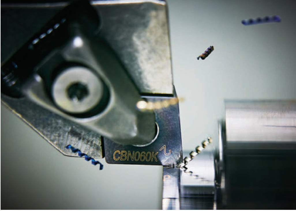

Holding a few tenths tolerance on a piece of 60-HRC steel was once the domain of expensive grinding equipment. Today, it's no big deal.
Courtesy of Seco Tools
Turning hardened steel with a CBN060K insert from Seco Tools.

Can a Plain Jane CNC lathe really eliminate a high-precision grinder and hold a few tenths tolerance on a piece of 60-HRC steel? Blake Bailey thinks so. He’s the senior manufacturing engineer at Bronson (Mich.) Precision Products, a division of Royal Oak Industries Inc. Bailey explained how his shop turns 60- to 62-HRC 8620 steel driveline components for Harley-Davidson, as well as 4130 casehardened parts with similar hardnesses for Caterpillar. “We hold 0.0003 ” to 0.0004 ” and 16 µin. Ra all day long on 15-year-old Wasinos, no problem,” he said.
Back up the truck! Using gang-style lathes bought during the Clinton administration to turn hardened-steel motorcycle components? “When you’re only removing 0.010 ” [of material], you don’t need a super rigid machine,” Bailey said. “We use an old linear-way machine that might have cost $50,000 back in the day, compared to a grinder that cost 10 times as much.”
Better yet, it’s faster to hard turn. A typical grinding operation might remove 0.007 ” to 0.010 ” and take 45 seconds. “We can hard turn the same thing in 25 to 30 seconds and get a minimum of 100 parts between tool changes. It works pretty dog-gone good,” Bailey said.

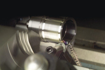

OD turning, with interrupted cuts, and facing operations for a 54-HRC 420 stainless injection mold component using a WNMG 432 insert from Seco Tools with a MF 1 chipbreaker and made from TH 1000 carbide.

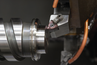

Rick Crabtree, product and application specialist for advanced cutting tools at Sandvik Coromant Co., Fair Lawn, N.J., is another believer in hard turning. “In a traditional process, the manufacturer used to blank the parts to a rough shape, heat treat and then do multiple grinding operations, dressing the wheel between each one,” he said. “It took a lot of time. With hard turning, you can usually turn everything in one operation.”
Hold on, though. This isn’t all sunshine and daisies. PCBN is brittle and expensive. Like its polycrystalline sister PCD, PCBN inserts can run up to $100 a pop. You can’t just mount one and hit cycle start. Machining strategy is critical.
“It’s important to securely hold the workpiece,” Crabtree said. “Don’t use a 3-jaw chuck; otherwise, lobing or vibration can be problems. It’s better to go with a collet or an air chuck and pie jaws, so you can clamp at least 70 percent of the circumference.”
He also recommends ramping in and out of the part to avoid shock. Holes or keyways should be chamfered ahead of time. “And if you need to hold close tolerances, anything under a few tenths, you might look at a two-cut strategy, where you semifinish within a couple thousandths before the final pass,” Crabtree said.
Does that mean you now have to purchase two $100 inserts? Maybe. But quite often, job shops are turning to less costly ceramic tools for roughing and semifinishing, and pulling out the PCBN big guns for the final pass.

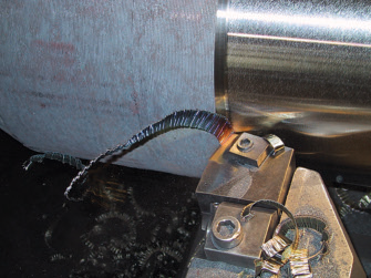

Courtesy of Greenleaf
Hard turning a heat-treated forged steel roll with an LNGN6688 WG-600 ceramic insert from Greenleaf.
Besides the cost, ceramic tools can take a deeper DOC and are more versatile, according to Shaw. “CBN inserts are usually tipped, limiting them to finishing cuts,” he said. “Ceramic has no such limitation. And while CBN is pretty workable above 55 HRC, it won’t be as reliable [when cutting materials in] the low 50s and high 40s, especially if you have inconsistency from your heat treat. Ceramic, on the other hand, will tolerate greater fluctuations in hardness.”
Someone who knows a lot about ceramics is Dale Hill, applications engineer for Greenleaf Corp., Saegertown, Pa. He sees extensive use of ceramic cutting tools in roll manufacturing for the steel industry. “The rolls are made out of either forged steels or high-chrome iron,” he said. “After initial machining, they are hardened above 50 HRC, but there’s still a tremendous amount of material to be removed. The parts are extremely large—4 ‘ or 5 ‘ in diameter and 15 ‘ long, weighing 30 tons. This is where ceramics really shine.”
