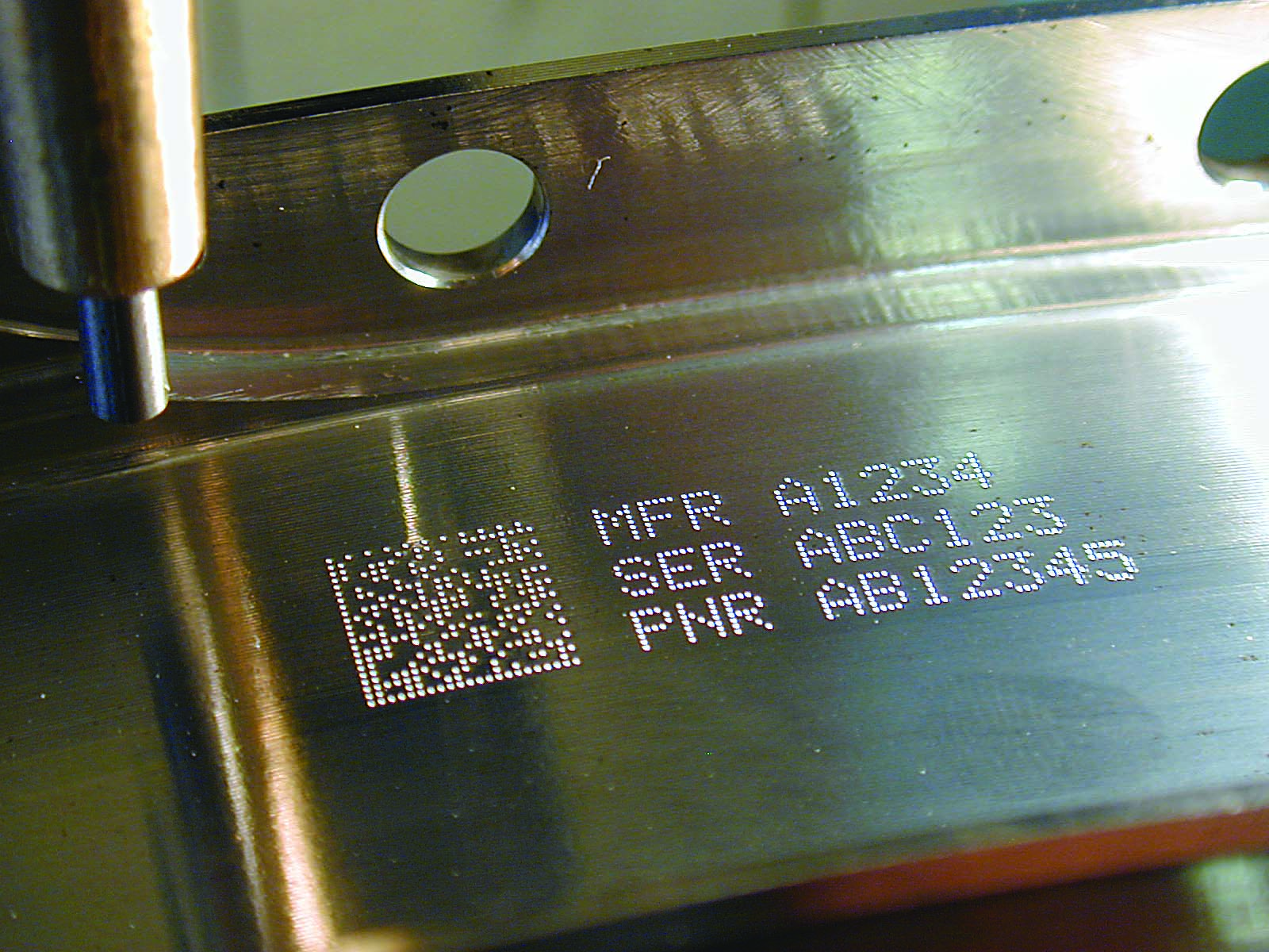

In the example above of dot peen marking, the mark is a succession of dots where each dot is created by the impact of the stylus on the surface.

The place of dot peen technology in the industry is as a high-speed, cost-effective marking system. Compared to laser marking, the cost of dot peening is low. Dot peen equipment ranges from $6,000 to $18,000 and laser marking equipment starts at $20,000 and can go up to $100,000, according to SIC Marking’s Bickel.
Dot peen technology is widely used to mark automotive, aerospace, oil and gas, agricultural and construction machinery and electronic parts.
Dot peening works by striking a carbide stylus assembly against the part’s surface. The mark is a succession of dots where each dot is created by the impact of the stylus on the surface.
A host of materials, from plastics to hard steel, can be dot peened using a range of styli. “The carbide stylus allows us to mark on harder materials,” Boffi said. “With plastics, we might use a smaller stylus, so less force is exerted on the part, or sharpen the stylus to a more acute angle, so characters have more definition.”

Most major industrial plastics, such as ABS and PVS, can take the impact of dot peening. Some plastics, however, may not have enough memory to hold a dot peen mark and others might be too brittle for the impact of the stylus. Also, ceramics are typically not marked with dot peen or scribing because the material is too brittle.
Dot peening is faster than scribing and can be faster overall than laser marking. While the laser marking speed is faster, the safety parameters necessary with laser marking may increase its cycle time.
