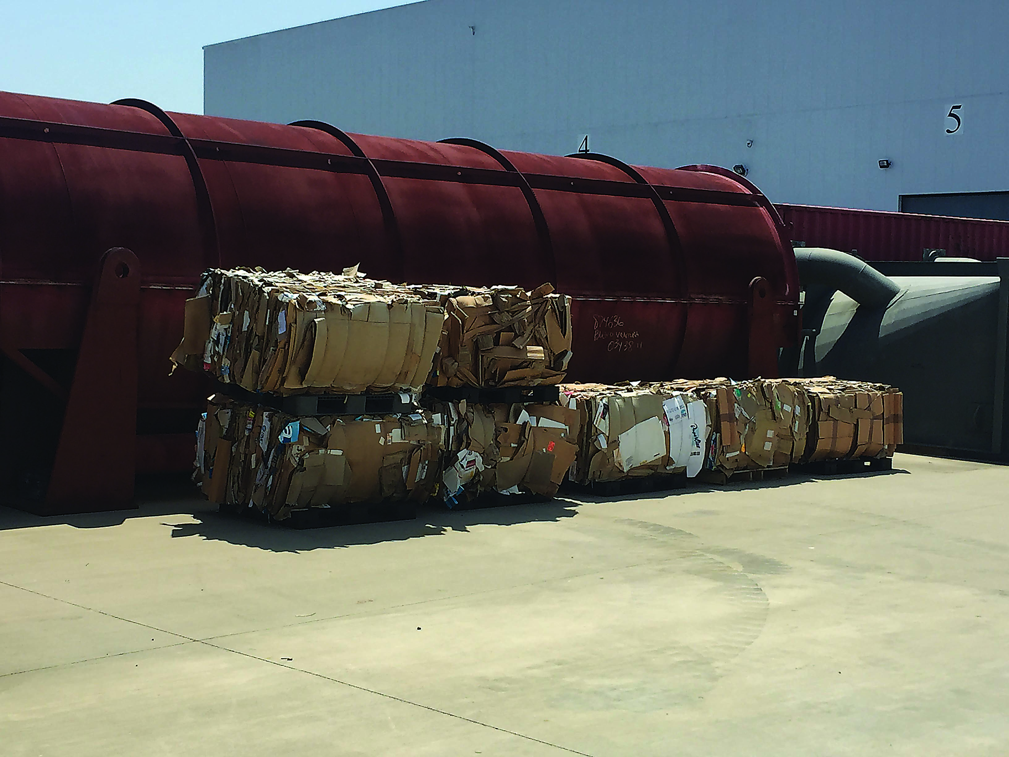

Cardboard has value as scrap if it is baled. We generate enough cardboard waste that the money generated from recycling offsets the cost of a bailing machine. Image courtesy of C. Tate.

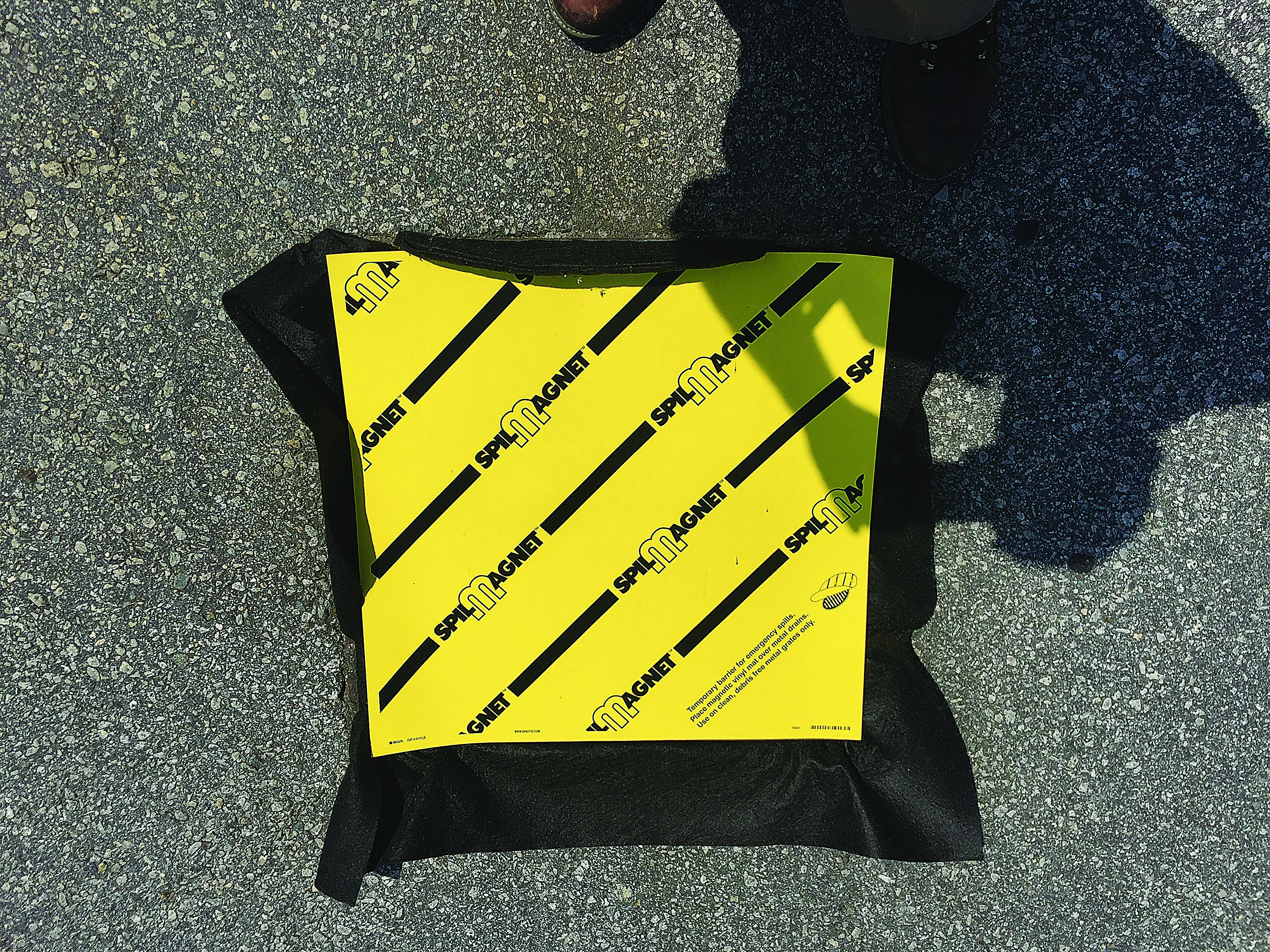

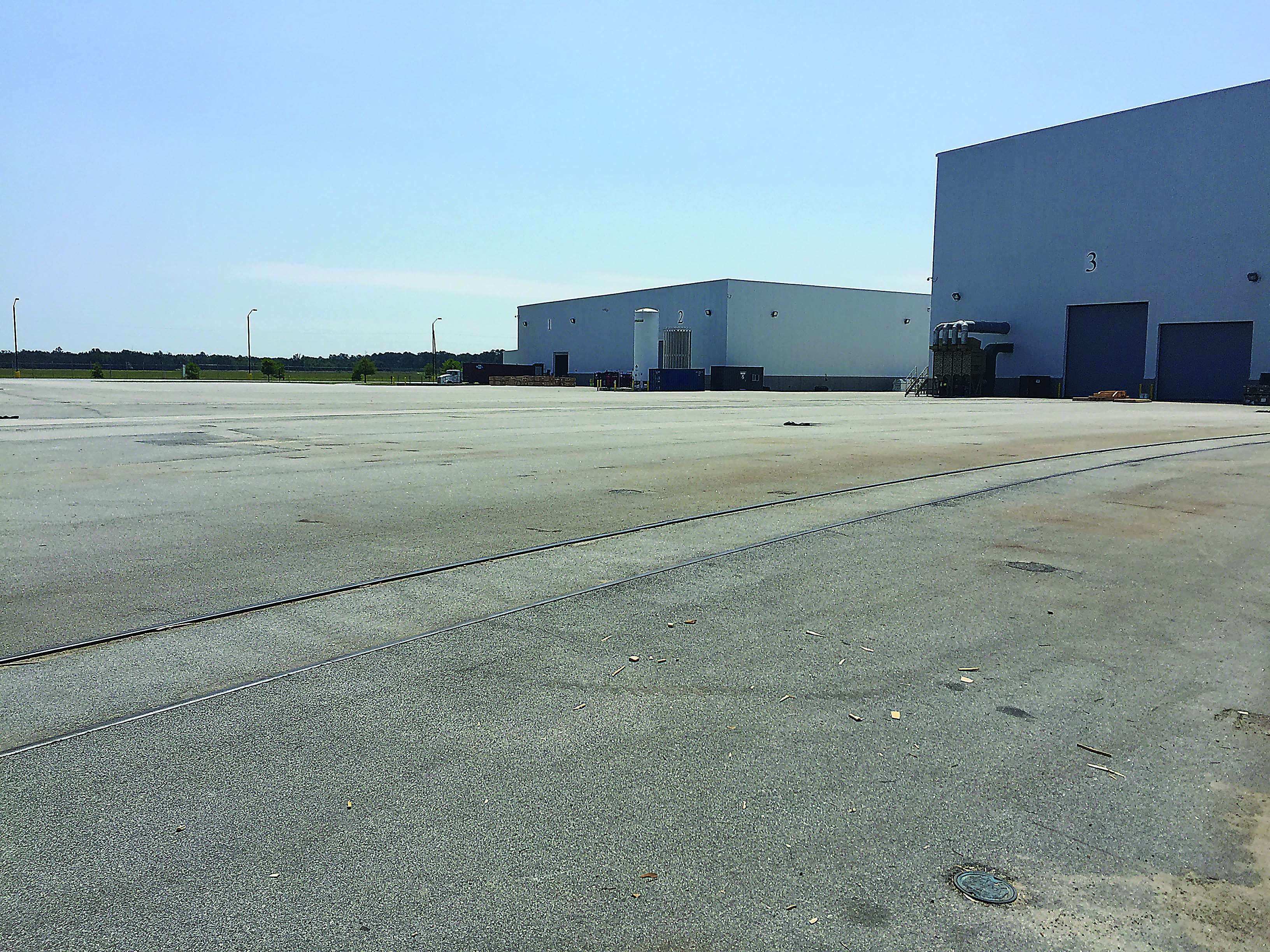

Mitsubishi’s campus has a vast amount of concrete, which creates millions of gallons of rainwater runoff each year. Each of the storm drains has a filter that captures silt and debris, preventing contamination of the watershed. Inset: Each storm drain has a magnetic cover, which can seal the drain if a chemical spill occurs. The filter paper is shown underneath the cover. Images courtesy of C. Tate.

Reducing solid waste was rather simple—we introduced a comprehensive recycling program. We purchased a machine that bales cardboard and now sell those bales to a recycling company. Also, we chip old crates, skids and other wood, and sell those chips to a recycler.
These chipping and baling activities have reduced storage costs because we need less space to store materials and no longer need multiple dumpsters. Chipping and baling also make the materials desirable to recycling companies. As a result, the revenue stream offsets the cost of the equipment.

Mitsubishi has a large campus with lots of concrete that, when combined with annual rain fall of 50″ (1,270mm), produces millions of gallons of storm runoff. Large industrial sites must protect the water that flows off concrete areas and buildings from becoming contaminated and possibly impacting ecosystems.
We have programs in place to prevent chemicals, litter and other undesirable materials from getting into storm water. All outside chemical storage is covered and kept surrounded by dikes to prevent spills and leaks from escaping the storage area. Spill kits are kept not only in areas where chemicals are stored but also in the traffic lanes where the chemicals are transported. As additional protection, we install magnetic covers to prevent liquids from entering the storm drain if a spill occurs.
Trash that escapes from the site in storm water is also considered a contaminant. Preventing trash from washing away starts with good housekeeping. It also requires all trash containers to be tightly covered and secured during stormy weather.
