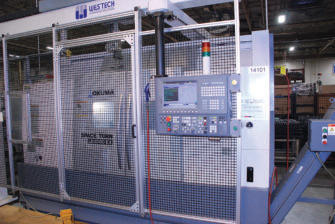

Mercury Marine’s Okuma LB3000 EX BB MYW800 is equipped with a Wes-Tech overhead gantry for loading and unloading shafts. Image courtesy Okuma America.
Recently, Mercury added a LB3000 EX BB MYW800 from Okuma America Corp., Charlotte, N.C., which has live tools, a Y-axis with 5″ of travel, a W-axis subspindle and a hob assembly from WTO Inc., Charlotte. The new machine produces a complete driveshaft in 3 to 4 minutes. It is equipped with a Wes-Tech overhead gantry for loading and unloading shafts.

“In the main spindle, we start with a blank that has been carburized,” said Kurt Lefeber, a Mercury process engineer. “We turn some of that carburizing off, giving greater definition to the part shape. We rough and finish one end and then transfer the shaft to the subspindle, where it’s roughed, finished, center-drilled and hobbed.”
