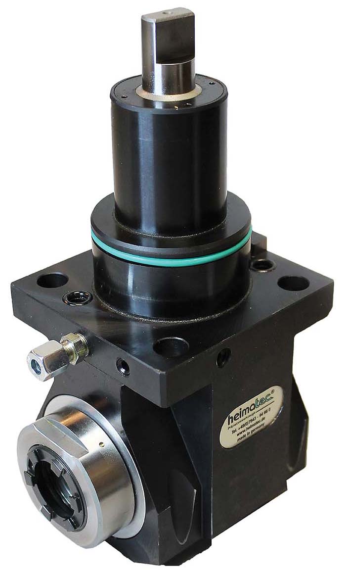

Heimatec’s BMT 65 face-working tool adds versatility to what can be done on a lathe. Image courtesy of Heimatec.

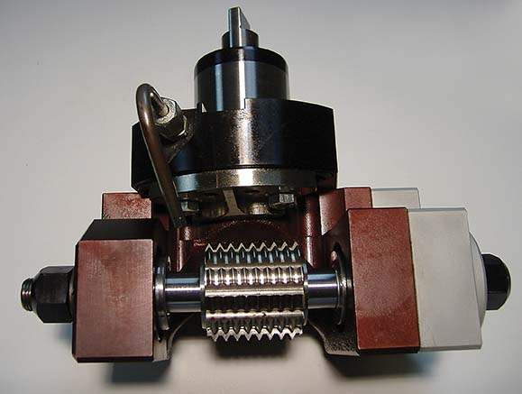

MD Tooling’s Grohs offered gear hobbing as an example of an advancement in live-tooling capabilities. “Many of our customers, in all industries, would outsource parts to have this operation done. Now, our hobbing unit has kept these jobs in the lathe—and in our customers’ control,” he said. “Gear cutting in a lathe is relatively new in the last few years, but advancements in this area helps us keep our customers happy and profits where they belong.”

MD Tooling’s gear hobbing tool allows a job that used to be moved to a customer’s mill to be kept on a lathe. Image courtesy of MD Tooling.

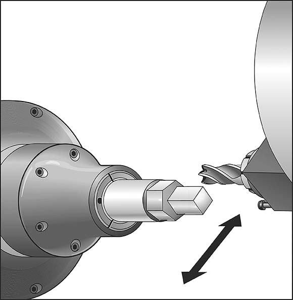

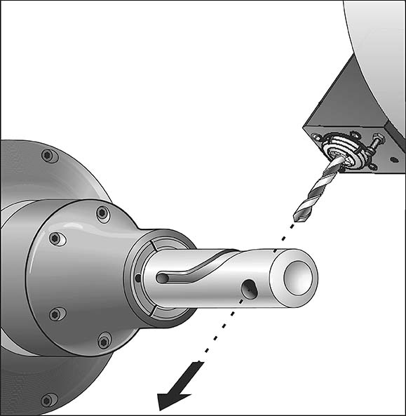

Live tools can be used for axial (above) and radial (below) cutting. Image courtesy of Haas Automation.
