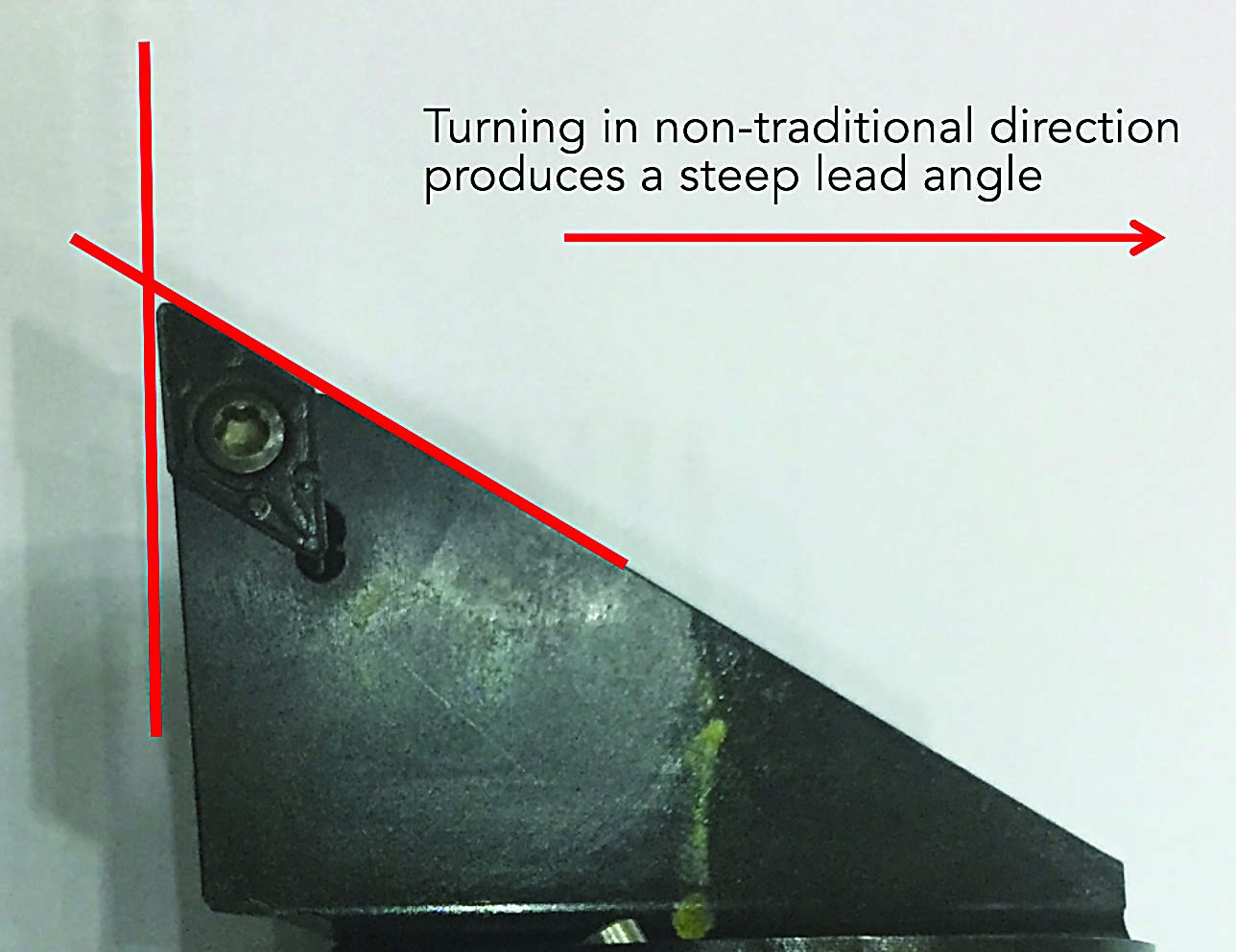

Newer tools and techniques capitalize on the step lead angle produced by using a common shape in a nontraditional way. Photo credit: Christopher Tate
Newer tools and techniques capitalize on the step lead angle produced by using a common shape in a nontraditional way. The steep lead angle produces a thinner chip, thereby reducing forces and aiding chip control. Image courtesy of C. Tate
Although groove turning is effective, it has limitations—like causing chatter when applying small tools—that cannot be overcome by changing the design of the cutting tool alone. In the most recent advances, tool manufacturers have partnered with software developers to create tools and toolpaths that capitalize on axial and radial chip thinning, thereby reducing chatter. The techniques involve round inserts or large radii paired with light radial engagement and high axial feed rates. These methods not only reduce chatter but improve the mrr, impart finer finishes and often increase tool life.
Another recent advancement utilizes inserts that resemble standard ISO diamond and triangular shapes. The inserts are held in standard orientations and are capable of being used in traditional ways. However, the inserts are slightly different from the standard shapes as they have a compound angle and built-in edge that creates a very large lead angle when programmed correctly.
Traditional toolpaths move the tool axially toward the headstock of the lathe with a relatively shallow lead angle. Improved inserts combined with the proper toolpath produce relatively large lead angles that result in thinner chips and lower cutting forces. However, there’s a trade-off because a large lead angle increases a tool’s surface area on a part and therefore increases the tool pressure. Reduced cutting forces allow deeper radial engagement and higher feed rates culminating in higher volumetric removal rates.

Because the back of the insert is used, the programmer is required to change toolpath methodology by selecting toolpaths that move the tool away from the headstock. Developing these types of toolpaths is somewhat unconventional, so CAM systems are not always cooperative. In response to these developments, toolmakers are working with CAM developers to create canned turning routines that allow easy toolpath creation, which makes adopting the new methods much easier.
