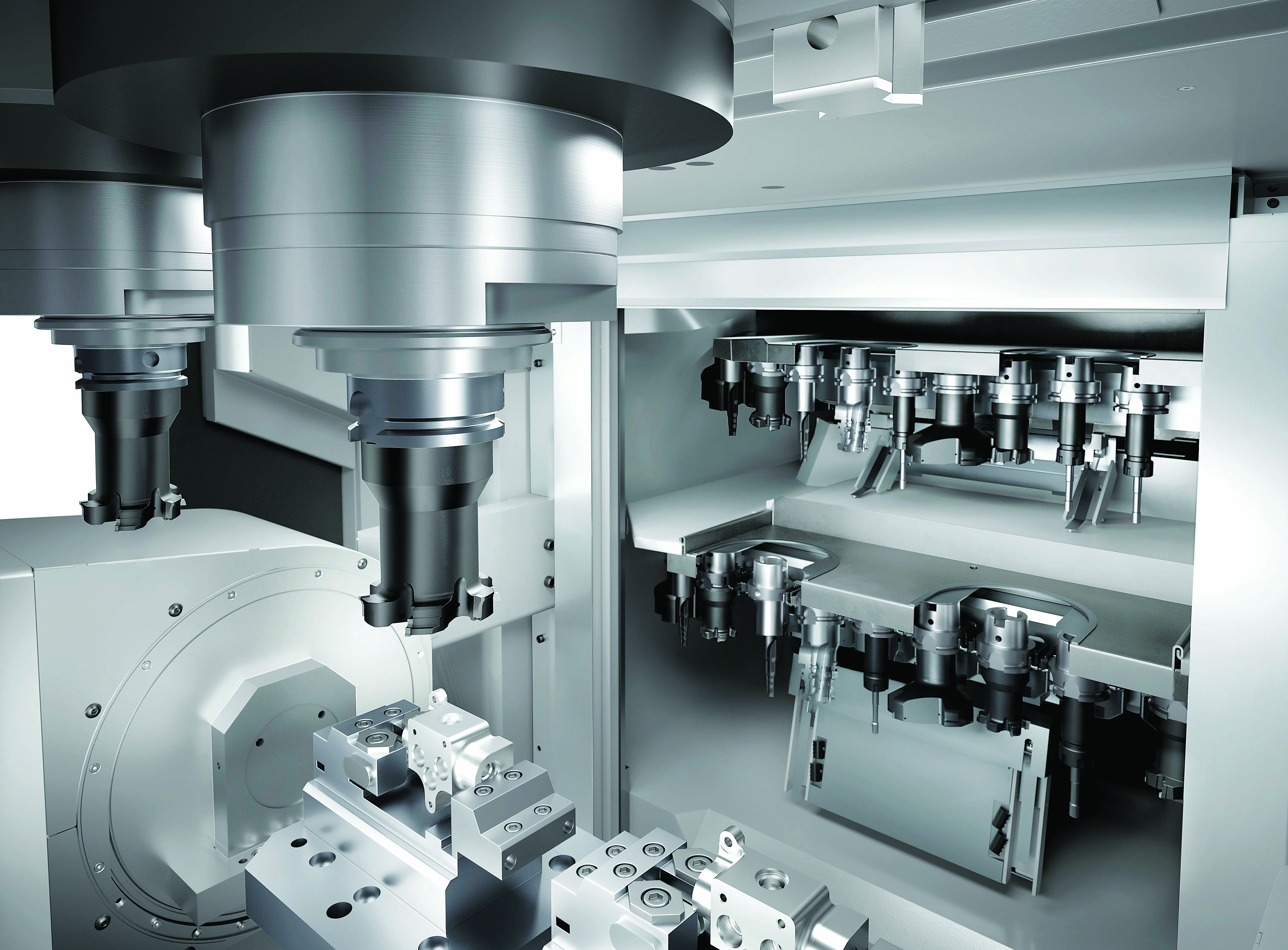

In some situations, twin-spindle machining centers do rule. Graham Roeder, national product manager at Jtekt Toyoda Americas Corp., Arlington Heights, Illinois, said primary users of the company’s Gemini XL line of twin-spindle machining centers make automotive parts, such as steering knuckles and brake caliper components.
“But twin spindles present significant advantages to pretty much any high-volume shop, automotive or not,” he said.
Roeder said the number of sales inquiries for twin spindles has been rising. Even companies that replace antiquated twin-spindle machines can look forward to dramatic performance improvements. Today’s twin spindles are better in every respect, with larger tool magazines, higher accuracy, faster spindle and traverse speeds and, perhaps most importantly, integrated automation.
According to Jtekt Toyoda Americas, Gemini XL twin-spindle machining centers present significant advantages to any high-volume shop. Image courtesy of Jtekt Toyoda Americas
There’s just one problem: These new and improved machine tools are no easier to set up than those of yesteryear. The tool length and diameter on the right-hand spindle must match those of the left-hand spindle, and fixture placement and construction must be equally precise. He said accomplishing all this requires enhanced planning and a high level of engineering skill, which is why many customers purchase machines as turnkey systems — tooled up, programmed and ready to get to work.
“We’re typically building complete packages to order, with most going out with rotary tables and some level of automation,” Roeder said. “Compared to the typical 40″×20″ (1,016 mm × 508 mm) single-spindle machining center you can find in any job shop, twin spindles are purchased with one thing in mind: maximum spindle utilization. For that, you want either a pallet changer or robotic part handling.”

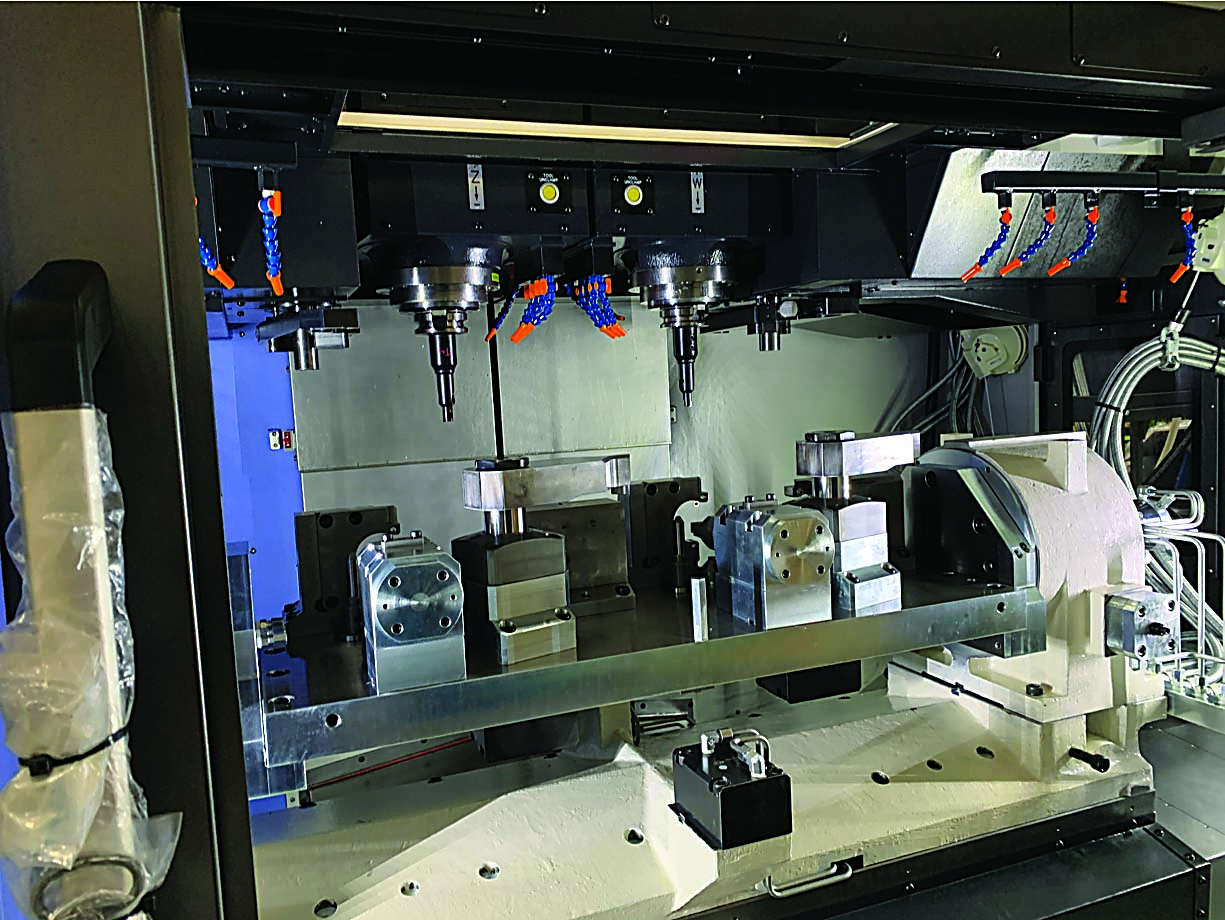

An additional difference in the world of twin spindles is the presence of a w-axis. In Jtekt Toyoda Americas’ case, this provides up to 20 mm (0.787″) of independent z-axis travel to compensate for any differences in tool length. A w-axis is a nice feature, though it’s probably less important than it once was.

Chiron America Inc., Charlotte, North Carolina, is enjoying similar demand for twin spindles and has released a machine model, the FZ/DZ 25, in response. Ross Clark, account manager and product specialist, said the FZ/DZ 25 is a bridge-style machine that boasts 800 mm (31.496″) between spindles, with each spindle able to traverse independently in the x- and z-axes. Tool changes are independent as well, and the machine can be equipped with either a dual five-axis trunnion or a “w-style table,” or rotary pallet changer.
