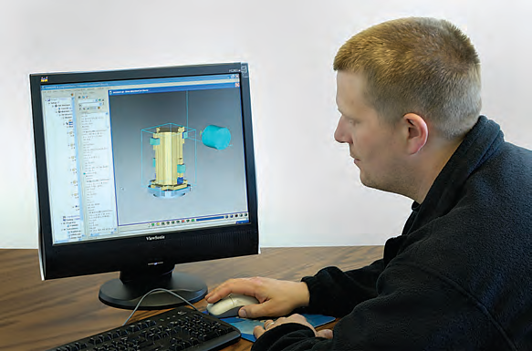

Brian Daavettila, who programs horizontal machining centers at Hydraforce, uses Vericut NC-verification software to verify the machining program for a hydraulic manifold block. Daavettila shares information generated by the software and his programming approach with setup personnel in a collaborative effort to maximize product quality and reduce setup times.

To address those production issues, the facility began to implement Vericut NC-program verification software from CGTech, Irvine, Calif., in early 2007 for the manifold machining process. The software simulates and verifies NC toolpaths to eliminate programming errors and reduce cycle time.
HydraForce loaded the program with information regarding all aspects of the machining process, including tooling and fixturing. Sexton pointed out that the seven Kitamura VMCs are identical, down to their 150-tool magazines. “We can run any program, in any machine, at any time and not have to worry about having tools in incorrect pockets,” she said.
Now, manifold designs from the HydraForce engineering group are programmed in Mastercam, and Vericut software simulates and verifies the NC program. The simulated part is compared to a Pro/Engineer model of the part using the simulation software’s Auto-Diff feature, which matches the simulated model to the design model to assure the toolpath accurately represents the original design concept. That feature also enables programmers to check for gouges or excess material generated by the NC program and to correct those program errors prior to machining.
“The software allows us to do a real simulation of the machine in the office at the computer, instead of at the machine,” Sexton said. “It runs the G code and will tell if there is a potential crash. It has actually caught errors in some of our Pro/E design files from engineering. That alone has saved the company thousands of dollars.”
In addition, setup time was reduced. Jay Brizzolara, who handles scheduling for manifold machines, said, “Our setup times went from a couple of days to about 3 hours.” As a result, the facility has reduced the minimum cost-efficient lot size from 54 pieces to 20 to 25 pieces. Brizzolara added that the software “makes us feel comfortable not sitting through the setup run the whole time; we have the confidence it is not going to crash the machine because of a typo in the program, a depth that is too deep for the drill or any other unforeseen event.”
Sexton noted that since the facility implemented the simulation software, there have been no machine crashes due to programming errors.
