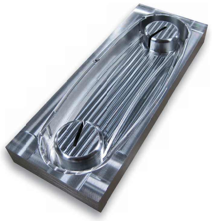

Steve Phillips, owner of full-service prototype and light-run CNC machine shop Phillips Precision Inc., Boylston, Mass., adjusts machining strategies to match customer requirements. To make one prototype copy of an approximately 4 “×14 “×1½ ” aluminum computer component on a rush basis, he employed workholding and machining approaches focused on producing the part as quickly, accurately and reliably as possible.
He calls the workholding method “line-to-line frame support.” The technique can be described as a tightened version of picture framing, in which the workpiece acts as the fixture. In a typical picture-framing situation, a shop machines a part out of the center of a large piece of stock, leaving the part attached to the surrounding “frame” via tabs or tags. The tags are then cut, and their stubs are removed separately. “Support tags are not a bad thing, but then you’ve got a lot of hand work to do,” Phillips said.
In the line-to-line approach, Phillips machines directly to the specified part dimensions. The tool is programmed to cut around the part’s nominal periphery, so stock does not remain, and to the full part depth. Then the stock is flipped on the machine table, and “on the other side, you machine to the line. So you are going line to line on the outside and line to line on the inside,” he said.
Phillips said the process seems counterintuitive. “Your brain is telling you there is no way that thing is going to fall out [of the frame]. In a perfect world, if the cutter was truly dead sharp and there was no tool deflection, it would probably break through.” However, the part remains connected to the frame, hanging by 0.0005 ” to 0.001 ” of material all the way around. The reason, he said, is that the carbide cutters the shop uses “always come in under size” and never cut exactly to size because of side load and tool deflection.
Courtesy of Phillips Precision
Phillips Precision made one prototype copy of an aluminum computer component using a “line-to-line frame support” workholding and machining strategy. The part is shown still encircled in the workpiece stock from which it was machined.
“The corner of the cutter is never going to be perfectly sharp,” Phillips continued. “I’m sure it has a 0.0005 ” to 0.001 ” radius, especially after it has been used. I’ve found you don’t have to fear breaking through.” When machining on both sides of the part is finished, “All you do is take the stock out, give it a rap on the bench and the part will fall out of the frame,” Phillips said.
The key to stability during machining is the small amount of material left between the part and the frame. According to Phillips, the part may be held by a bridge of material about 0.001 ” thick, but there is virtually no gap between the part and the frame. “If you had 0.010 ” gap between the outside and the inside, that 0.001 “-thick bridge isn’t going to be too strong. But the gap is almost nothing.” Any tab material that remains can be removed with minimal hand work.
Phillips said the technique reduces the time required to devise a fixture, especially if the part is delicate or has an irregular shape. The component in this example has a few wall thicknesses of about 0.125 “. “It doesn’t have too many flat surfaces,” Phillips said. “It’s a fairly difficult part to hold, without getting really involved with making fixtures. You’d have to make soft jaws, but they are not going to hold it as accurately as this. This way allows you to hold it very efficiently.”
Although some may think the method consumes too much stock, “we didn’t spend any time making fixtures,” Phillips said. “The price of stock was $44. You can’t make much of a fixture for under $50.”
Another benefit is the part is machined from the heart of the material. Therefore, the final product “is actually more stable because you are not taking it out of one side or the other of the stock, where you have stresses,” Phillips said.
He cautioned that because the frame supports the part, it is important not to skimp on raw stock dimensions. “If you get chintzy with your frame, you are not going to have much to hold onto.”
For example, the stock left at the bottom of the part has to be sufficiently thick. The floor material between the frame and the intersecting cut lines “is what that part is hanging from,” Phillips said. “People may try to machine right down to the floor, then the part starts dancing around in there.” In this example, the beam at the floor of the workpiece is about 0.200 “. “If you made that 1⁄32 ” it isn’t going to work. The beam has to reach out ½ ” and support that part,” he said.
