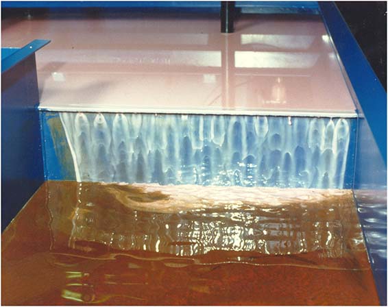

Coolant flows from the clean side to the dirty side in a SmartSkim batch recycling/filtration system from Universal Separators.
In addition to a bag filter that removes suspended solids, Hanna explained that the company’s Guardian coolant recycling system has a barrel skimmer that sits below the coolant surface and a double-diaphragm air pump that pulls the coolant and rag layer into the tramp oil separator. In the separator’s first chamber, the layer of tramp oil rises to the top and is extracted through a weir.
The coolant then travels through a baffle into the second compartment, or media section, where coalescing occurs, turning small droplets of tramp oil into larger droplets. That’s achieved by flowing the coolant through plastic tellerettes and pall rings, which grab the small droplets and form larger ones. The droplets then rise to the top of the surface with the assistance of an air sparger and are extracted through a second weir. The separator keeps removing contaminants as gravity overflows coolant from the clean side of the system to its dirty side in a continuous processing cycle before the clean coolant is fed back to the machine sump.
“If you’re doing a 200-gal. sump, it’s fair to say in 3 to 4 hours you remove 98 percent of all tramp oils,” Hanna said. The company’s standard systems process up to 1,500 gal. per hour.
He noted that system options include an ozone generator to kill bacteria, a polishing filter for particle filtration down to 5µm and hose reels. For example, while an installation might feature a fully automatic, closed-loop, central recycling system, such as one used by NASA, other customers use hose reels to top off sumps or recharge coolant after cleaning. “The hose reels are filled with clean coolant and, as a sump is evacuated, they just pull the handle, like when filling a car’s gas tank, to fill up the coolant sump,” Hanna said.

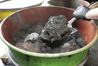

Sludge.tif
Courtesy of Sanborn Technologies
There are four basic steps to removing separated sludge from the Sanborn T10-3-315:
  1. Switch off the centrifuge and remove the housing and rotor cover by disengaging the quick locks.
  2. Remove the filled sludge basket and clean the basket by removing the compacted sludge.
  3. Reinstall the cleaned sludge basket.
  4. Reinstall the rotor and housing cover and switch on the centrifuge.
