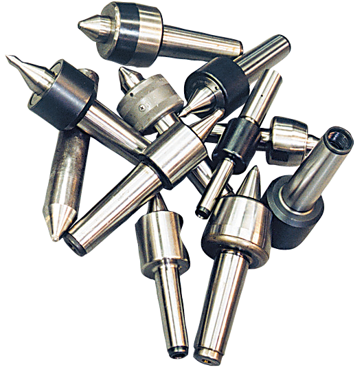

These centers, sent in for repair, were in good working order when originally installed.

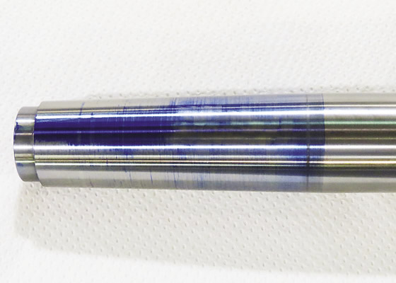

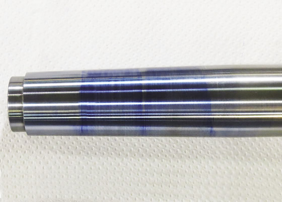

Bluing is a good way to check quill wear. After a blued center taper is inserted into the quill, the bluing should be light and even (top). Heavy bluing indicates the taper did not contact the quill interior, while gaps mean the fit was too tight (bottom).

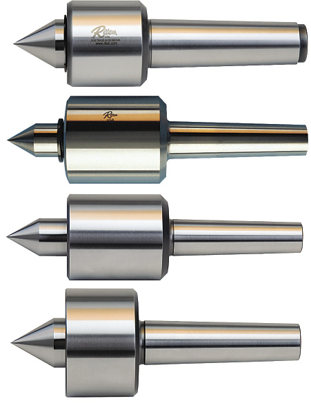

4%20Similar%20Centers.tif
These four Morse Taper live centers have common specs for accuracy, maximum spindle speed and workpiece weight capacity, but users should consult the manufacturer to determine which one is correct for an application.
However, literally thousands of standard and modified centers are available, each designed for specific applications. Center designers select bearing sets, seals and internal lubrication to accommodate varying operating conditions, including the DOC, surface feed and required surface finish. It is always best to consult the center manufacturer about the details of the turning or grinding operation rather than choosing a standard center from a catalog that may not be appropriate for the job.

Over time, the tailstock quill, which holds the center, may become out of round and loosen its grip on the center taper. This causes the center to wobble, producing chatter, greatly reduced accuracy and out-of-spec parts.
Quill wear is easy to check. Live and dead center tapers should be manufactured to tolerances much tighter than typical tailstock quill specs, and, therefore, can serve as accurate taper gages. Apply bluing to the center taper and insert it into the quill. Upon removal, if the bluing shows irregularity or gaps, the quill taper requires repair.
