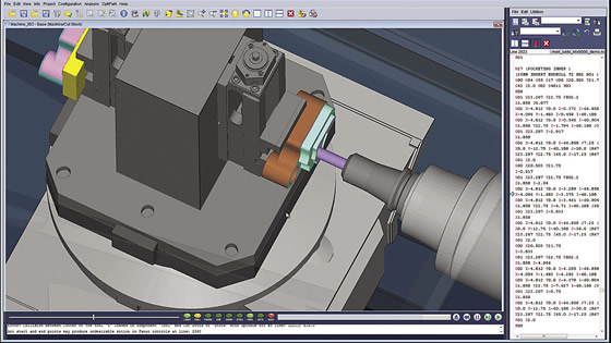

This last part—offline simulation—is probably the most time-consuming. Simulating CNC toolpaths to check for interference and potential crashes means every part of the machine setup must be modeled, from vises and chucks to cutting tools, toolholders and machine tools. Without online or offline simulation, program verification becomes uncertain and error-prone.

Toolpath simulation of a tombstone-fixtured workpiece on a DMG Mori Seiki horizontal machining center.
The good news is that a number of tooling manufacturers offer CAD files of their products online. Programmers can log into the manufacturer’s Web site, enter a product code and download the file. Not every manufacturer is onboard yet, and it’s possible those CAD models will need some tweaking. And once you have electronic versions of every jaw, clamp, vise, chuck, knob, insert and holder used in the shop, someone in the company has to manage that data. Is all this work really necessary?
Bill Hasenjaeger, product marketing manager for simulation software developer CGTech Inc., Irvine, Calif., thinks it is. “Accurate modeling requires a complete representation of the machine setup,” he said. “Shops with this information catch collisions and tool interference in the programming office. Those who don’t have it discover these problems on the shop floor.”
Despite this, Hasenjaeger indicated that many shops don’t bother with complete modeling until the cost of failure becomes unbearable. When you’ve scrapped a $30,000 workpiece or spent weeks waiting on replacement parts for a crashed machine, a few hours of modeling seems worthwhile. “Those who accurately model toolholders and fixtures as part of program simulation definitely realize a benefit in machine uptime,” Hasenjaeger said.

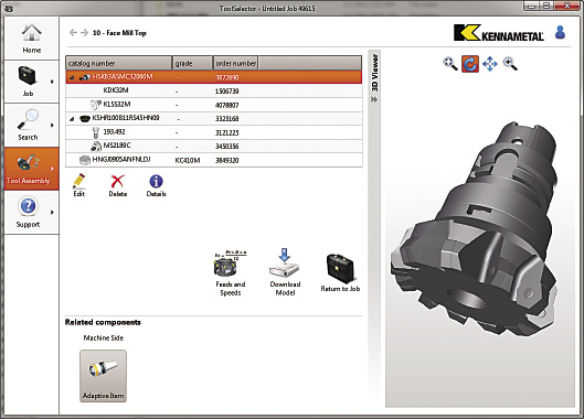

Kennametal’s NOVO is used to view a solid model of a facemill via Machining Cloud.
Fortunately, the days of hand measurements, paper catalogs and endless Internet searches for tooling dimensions and downloadable CAD models may soon be coming to an end. An increasing number of CAD/CAM suppliers—CGTech included—are partnering with tooling manufacturers to make modeling faster and easier.
“Cutting tool manufacturers, in particular, are beginning to realize their customers are using simulation more often, and, therefore, need good tool models,” Hasenjaeger said. CGTech participates in this effort through NOVO, Kenna-metal Inc.’s system for bringing CAD data to the desktop.
Together with Machining Cloud GmbH, NOVO supplies cloud-based tooling information for a number of CAD/CAM systems. According to Hasenjaeger, all that’s required is a few mouse clicks to download and unpack a zip file with the STEP (STandard Exchange of Product data) assemblies necessary to construct the tool and an XML file that contains descriptive information.

Mathews explained that the information needed for part programming and setup is scattered. “Shops end up doing Google searches, checking the manufacturer’s Web site, leafing through paper catalogs and developing in-house databases.” The cloud can be a powerful tool for providing this information, he said.
This isn’t just about downloading the dimensions for a vise or a DXF file for an indexable shell mill. Machining Cloud automates much of the computational work normally done by programmers and engineers, pulling together the various components of a tooling assembly into a complete 3D model.
“In the case of workholding, we prep it using special coordinates so that it can be mounted onto digital machines,” Mathews said. “This eliminates the engineer’s having to find each individual CAD model and fit them all together. We provide a solid model of the complete assembly, formatted to whatever CAD system is being used.”

The ability to pull tooling information from the cloud provides a significant advantage to part manufacturers. “One example of this is workholding,” said Steve Bertrand, business manager for CNC Software. “Without an accurate vise or fixture model, about the best you can do is draw an avoidance area on the screen, mapping out the area where tools shouldn’t go.”
This crude representation doesn’t always cut the mustard, though, and operators are often left holding a sweaty hand over the emergency stop button during initial program run-through.
“The nice thing about a solid model is that you can see the details,” Bertrand said. “If the workholder and tooling is drawn to scale, it’s beneficial to programmers because it gives them the information needed to determine the best machining strategy. It makes the job a lot easier and the entire process more efficient.”
Most importantly, it prevents crashes. “I’ve witnessed the results of poor tooling representation. The programmer thought the clamp was over there, and the next thing he knows the operator is standing at his desk because the cutter ran into the fixture,” Bertrand laughed. “Actually, back in the day, I might have caused a few of those situations. I’ve learned since that the more you can show, the better the chances of avoiding a catastrophe.”
