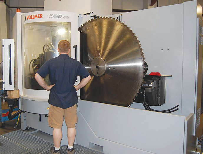

The Vollmer CHMF 400 dual-side grinder is for manufacturing and resharpening carbide-tipped saws up to 87 ". Inset: Specialty Saw's Dave Medeiros (left), general manager, and Dave Nagy, owner.
Specialty Saw ultimately decided to purchase two saw grinding machines from Vollmer of America Corp., Carnegie, Pa. Those were the CHM 400 top and face grinder and the CHMF 400 dual-side grinder for saws up to 87 " in diameter. "This newest generation of equipment was specifically made for the metalcutting saw industry," Nagy said.

Previously, the largest carbide-tipped metalcutting saw Specialty Saw could produce and sharpen was 67 " in diameter. In addition, the largest saws produced on the new machines are just as precise as the smallest saws that were produced on the company's old machines, according to Medeiros.
Nagy added that tolerance is within ±0.005 " on circumference for the large-diameter blades. "Blades have a center hole that's probably 0.003 " or 0.004 " oversize so there's enough slop there to fit it on the machine, meaning you're out of round already," he said, noting that those grinding such saws on older equipment to within 1⁄32 " ±0.015 " "would be dancing. For a big 60 " saw blade, it's unheard of to hold a concentricity of 0.002 " to 0.004 "."
Unlike the older machines, the new ones are able to fully enclose and seal the portion of the blade being ground, enabling a more effective application of grinding oil to achieve tighter tolerances, according to Nagy.
He added that the enhanced precision is also the result of the new generation of equipment from Vollmer being more rigid, in part because the casting is made of cast iron. That increased rigidity, along with the machines' modern controls, improved turnaround time for blade production by a factor of three, Nagy noted.
The new saw grinders also enable lights-out machining. "In one setup, if it's a 3- or 4-hour process for a blade, you can hit the reset button and go home, knowing the blade will be done in the morning," Nagy said. "It grinds the facets of every tooth, and if it has to take five passes on a tooth, it does."
