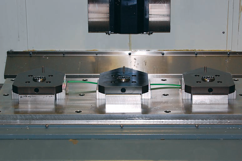

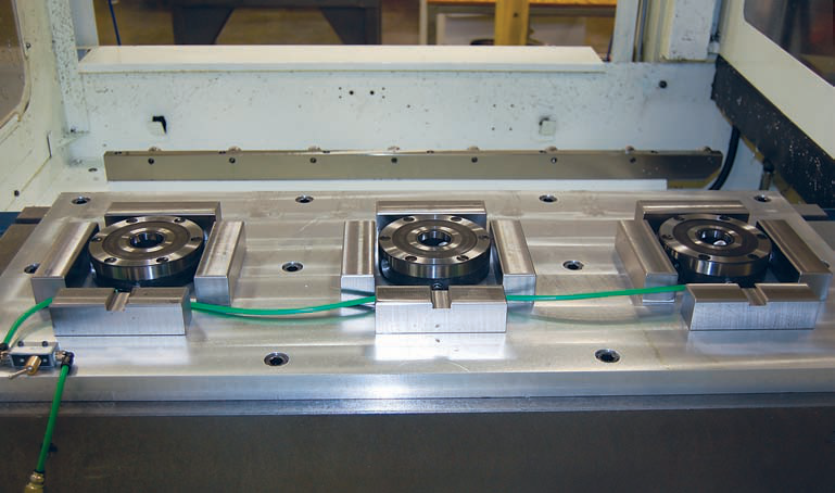

Minneapolis-area prototype and production shop Park Precision Machine fitted one pallet of its Kitamura VMC with chucks for the UNILOCK zero-point clamping system. The upper photo shows the chucks installed on a plate on the pallet, and the lower photo shows part fixtures with the zero-point system mounted on the chucks.

Park Precision machined the housing on a Kitamura vertical machining center with a built-in two-pallet changer. The shop first clamped three blocks of stock in vises on one of the machine’s pallets for an initial group of operations, which consumed about 7 minutes. When those operations were completed, the parts were removed and bolted to fixtures that were clamped in vises on the second pallet for another group of operations. Those operations utilized about 20 tools for contour milling, deep-pocket milling, drilling, tapping, reaming and boring, and took about 35 minutes.
At the beginning of each production run, the operator completed the first operation twice in a row so there would be a set of semifinished parts available to load on the second pallet while the first operation ran.
It was a classic case of hurry up and wait. When the second pallet came out of the machine, the operator would have to loosen the vises, unbolt the finished parts from the fixtures, bolt the fixtures on the semifinished parts and then clamp those fixtures in the vises again.
“The first operation required only about 7 minutes; that’s all the operator had for unloading and reloading the fixture on pallet two,” Tummel said. “He was very busy taking finished parts off and putting unfinished ones in.”
If Park Precision could find a way to reduce setup time for parts in the second operation, that would reduce the cutting cycle time by staying within the 7 minutes available while the first operation ran. “We had to make it fly,” Tummel said.
Considering the tight part tolerances, the shop also wanted to maximize machining accuracy. When the parts were loaded on fixtures and clamped in the mechanical vises, there was potential for part positioning error, and the part scrap rate was as high as 2 percent.
After seeing the UNILOCK zero-point system at the IMTS 2008 trade show and discussing the application with a BIG Kaiser representative, Park Precision placed an order with distributor Productivity Inc., Minneapolis, for a zero-point system to be fitted on one pallet of its VMC. “We saw zero-point as increasing our positioning accuracy, as far as our part loading and repositioning, and we saw it speeding up the process,” Tummel said.
He described the workholding arrangement: “We are running the first operation on pallet one while the semifinished parts are loaded on pallet two for the second operation, and vice versa. The zero-point clamping system is used on pallet two for the second operation.”

Fixtures with mounting knobs for the zero-point system are mounted on the face of the parts after the first operation, locating off a bore in the center of the part and on drilled and tapped holes. Then the fixtures are locked into the chucks on pallet two.
The zero-point clamping system reduced loading times for the three parts on pallet two by about 2 minutes. “Two minutes for a cycle doesn’t sound like a lot, but it is 6 or 7 minutes per hour that is freed up to make more parts,” Tummel said. “Using the zero-point system, we now are able to finish 4.3 housings per hour, up from 3.7 per hour previously.” In addition, Tummel reported that eliminating the need to bolt on and align vises has reduced the time required to set up the operation by more than 35 percent, from 13 hours to 8 hours.
Part quality was more consistent as well. “With the prior setup, we didn’t have nearly the rigidity that we have now nor the positioning accuracy,” Tummel said. He estimated that the zero-point system improved accuracy by 30 to 40 percent. As a result, scrap rate fell to 0.1 percent with zero-point clamping.
The repeatable part positioning provided by the zero-point clamping system also enables Park Precision to adapt quickly to engineering changes. Data regarding part position is stored in the machine control. “We use the same offsets for height and location to set up the next part. Only program changes are needed,” Tummel said.
Because the system is modular, Park Precision intends to use it for other parts in the future. “The zero-point system is not going to leave pallet two,” Tummel said. “We have already adapted our holding devices for the zero-point system. We will have faster setup times for future jobs.”

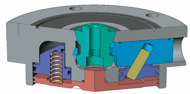

The UNILOCK zero-point clamping system from BIG Kaiser Precision Tooling features a precision-ground clamping wedge lock, or knob, (turquoise in this image) that is gripped in a chuck via a self-locking mechanical clamping system. Spring pressure drives wedges against the knob; air pressure is used to compress the springs and release the knob.
How zero-point clamping works
The UNILOCK zero-point clamping system from BIG Kaiser Precision Tooling features a precision-ground clamping wedge lock, or knob, that is gripped in a chuck via a self-locking mechanical clamping system. Spring pressure drives wedges against the knob; air pressure compresses the springs and releases the knob. The clamping knob is attached to a base plate, fixture or directly to a workpiece, and the chuck is mounted on the machine table or pallet.
The UNILOCK clamping knob mates with the center taper in the chuck to establish the X-Y centerline location, and a timing pin, or key, locates in a notch or bushing to restrict rotation. The Z reference is established by the bottom of the fixture or workpiece contacting the top ground surfaces of the chuck. These same mating surfaces (bottom of the fixture and top of the chuck) control axial alignment. The clamping knobs position to within 0.0001 ” TIR.
The system can be adapted to existing pallets, fixtures and workpieces while achieving up to 11,240 lbs. of clamping force. The system’s modularity enables it to adapt to workpieces of virtually any shape or size. Zero-point clamping chucks are available in different configurations for integration onto all types of machine tools, such as mills, lathes, grinders and EDMs, as well as measuring equipment such as coordinate measuring machines. BIG Kaiser says the UNILOCK zero-point clamping chuck system can reduce setup time by up to 90 percent.
