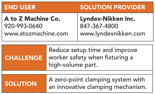

Challenge: Reduce setup time and improve safety when fixturing a high-volume part. Solution: A zero-point system with an innovative clamping mechanism.
