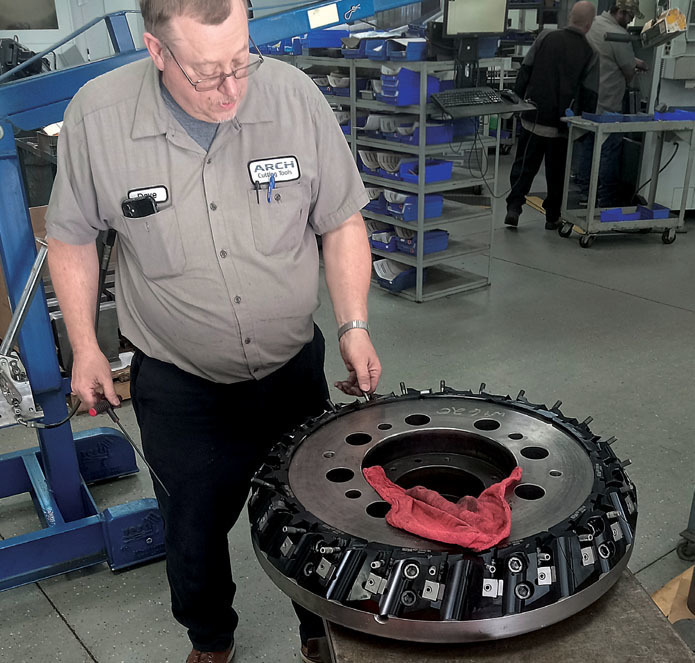

An ARCH employee assembles one of the toolmaker’s large diameter facemills. ARCH Cutting Tools)

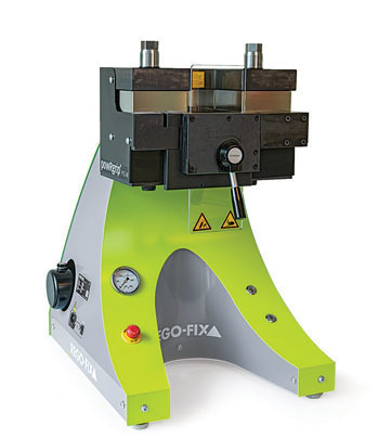

The limiting factor in quickly offering PG for that segment, he explained, was the system’s PGS tool setting press, or clamping machine, that capped out at 9 tons of clamping pressure. For PG 48 toolholders, he added, 15 tons of clamping pressure were required. “The development of that machine took years. It wasn’t something that we could just take our existing 9-ton machine and sprinkle some water on it and balloon the size up. We literally had to do lots of reengineering, lots of testing.”
McHenry added that securing a 40 mm-dia. tool requires more than 2,000 Nm (2,950 ft.-lb.) of clamping force. “That’s a lot of clamping force.”

Image of PGS tool setting press
The PGS tool setting press for the powRgrip 48 system requires 15 tons of clamping pressure. Rego-Fix Tool

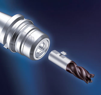

Miller added that a variant of that milling chuck is the Mega Double Power Chuck that features a smooth OD pre-balanced for high speed operations and a rigid design for heavy cutting. The expanded contact diameter of the chuck’s nut to the flange reportedly provides a level of rigidity similar to the chuck and nut being one solid piece, enabling aggressive machining without chatter.
“And then we take that chuck and make a Mega Perfect Grip version, which uses the Weldon flat to trap a cutting tool shank inside the milling chuck so it cannot rotate, and it cannot pull out,” he said. “It’s the ease of assembly of a milling chuck will all the anti-pullout properties.”

When it comes to large diameter tooling for heavy machining, Bloomfield Hills, Michigan-based ARCH Cutting Tools pushes boundaries. “For large diameter facemills, our Flushing location currently manufactures up to 30″ cutters,” said John Carstensen, shop floor manager for the toolmaker.
“ARCH Cutting Tools in Flushing, Michigan, provides a comprehensive selection of toolholders,” Carstensen noted, “including CAT 40, CAT 50, CAT 60, as well as HSK models ranging from 40A to 125A, along with collets and shrink-fit holders. Our offering begins with BT 30 (CAT style) and extends through CAT 60.”
