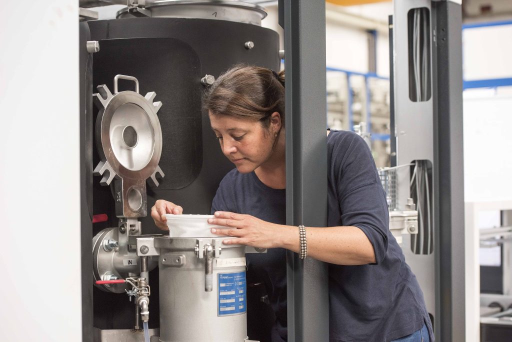

Systematic process analysis
Ecoclean ” data-entity-type=”file” data-entity-uuid=”1e296838-aa4a-4ff6-a399-186a42f3f614″ height=”351″ src=”/wp-content/uploads/legacy/inline-images/Ecoclean_FB_Prozessanalyse_2_V.jpg” width=”400″ />
So what do you do if parts suddenly come out of the system stained, if specifications for particulate or thin-film cleanliness are no longer met, the cleaned parts arrive at the customer’s corroded, or cleaning is too slow/too cost-intensive? In the case of these and other problems, a systematic process analysis such as that carried out by the Ecoclean Academy at Ecoclean GmbH can pinpoint the root cause of the error.
The cleaning experts not only focus on the actual cleaning process and equipment but also assess the overall manufacturing environment. The smallest change to the part, part spectrum or material, type of contamination, or modifications to upstream or downstream processes is enough to seriously impair cleaning results.
Stains and thin-film residues on parts
According to the cleaning experts, a poor cleaning result or one that does not meet new higher requirements is a “classic” reason for carrying out a process analysis. The first step is to identify the exact problem – are thin-film cleanliness specifications not being fulfilled or are there stains on the parts?
If staining is the problem, one of the questions to be asked is whether the quantity and composition of the contaminants (processing media and other substances) have changed or whether the constituents and concentration of the cleaning medium are still appropriate. Other factors, such as rinsing water quality, bath treatment, process technology, and process sequence, as well as the drying step, are also closely examined. These are further influencing variables that play a role if thin-film cleanliness results are unsatisfactory.
