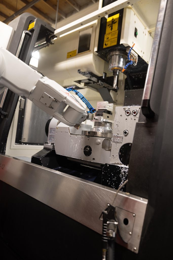

LoadMate Plus is an engineered robotic solution that can be used for machine tending. Expand developed and integrated a 4-foot-by-4-foot LoadMate Plus with an RV20 six-axis robot arm. It was easily connected to one of Tai’s machine tools, the GenMill 5X-12. Because this five-axis milling system was already equipped with a Mitsubishi Electric CNC, getting everything to communicate was easy.
According to Mitsubishi Electric Account Manager David Contreras, “The LoadMate Plus has been specifically created for easy setup and use.”
Plug and Play Machine Tending
LoadMate Plus offers flexible connectivity for plug-and-play machine tending. For communication, all that is required is a simple connection via Ethernet to integrate the LoadMate Plus with Mitsubishi Electric’s M8 Series CNC.
The system also offers easy programming of robot movements thanks to Direct Robot Control with CNC software. That means Tai can program and adjust on the fly using menus and G-code from the same screen used for the machine tool. No robot expertise is required.
To ensure precise placement of the part to be milled, the robot arm works with a flexible Schunk quick-change pallet system. Singh said, “Working with Tai, we chose to focus on a pallet system that allows the robot to pick up parts from the same location each time so you do not have to reprogram the robot from part to part. We chose to use Schunk for our pallet system needs because of their well-known rigidity, accuracy, and durability.”

It only takes 15 minutes to place 10 blanks on the loading shelves. From there, the system automatically loads and unloads the machine. Tai no longer has to stand by to remove a finished part and load new material. LoadMate Plus does it all and keeps going until the loading shelf is empty.
After implementation at TL Aerotek, the system ran unattended for 24 hours, tripling normal output. Tai Le is now able to complete a month’s quota in just a week.
