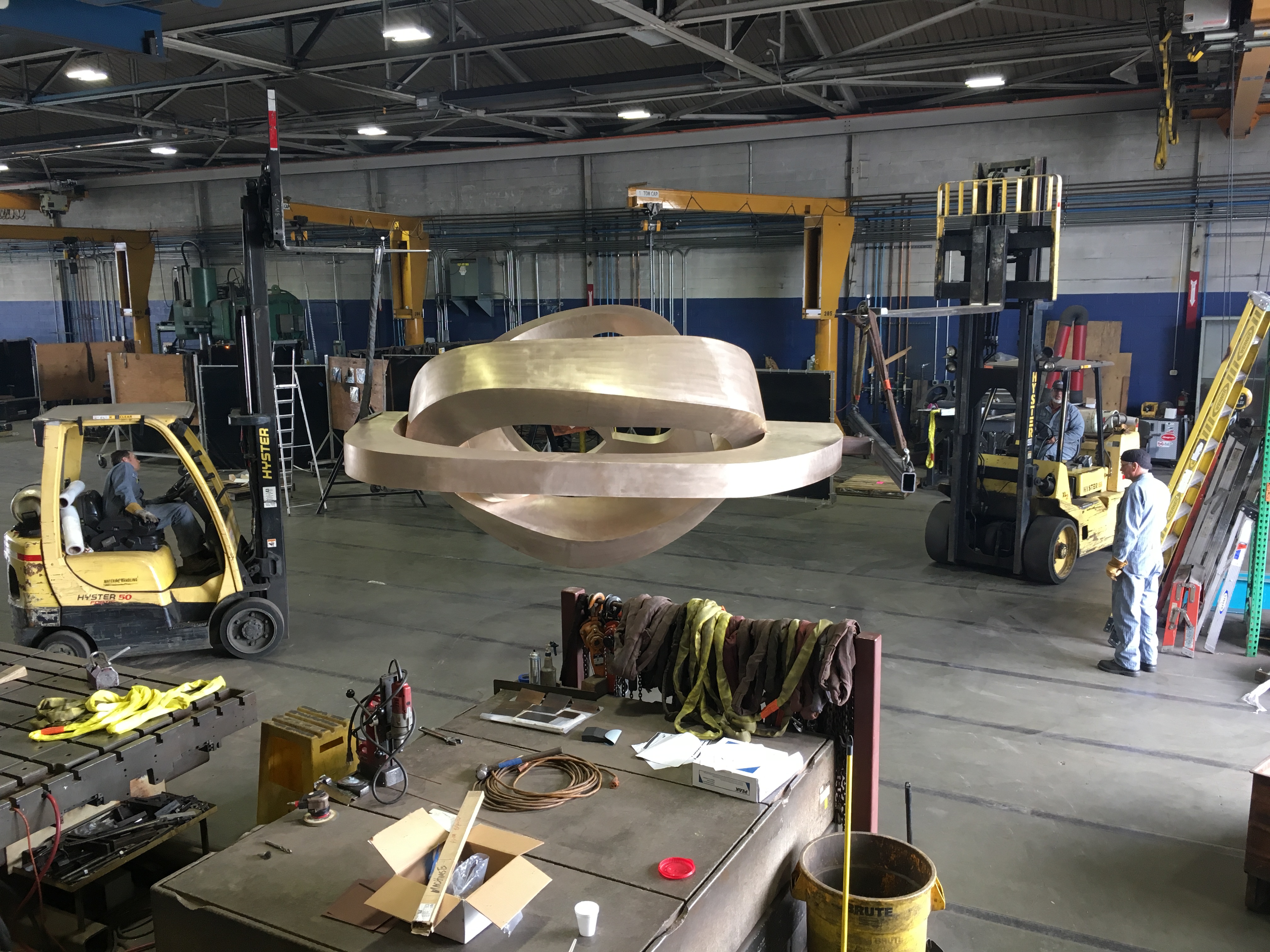

"She builds the small stuff," Pollard said. "When she needs something big, she comes to me and we talk. We scale them up. The largest ones are almost 4,000 lbs."
Pollard designs the work, often with AutoCAD, and coordinates with machinists. Anything requiring waterjetting or laser cutting is done by a contractor. Steel is the usual metal of choice, although aluminum and bronze also have been used. He said the machining and finishing are not particularly problematic. Rather, the shaping is most difficult.
"Welding distortion is an issue," he said. "That is a real challenge, and developing flat patterns for weird artistic shapes is an interesting challenge. But we're capable of building most anything."

WorWorkers at Machinists move a 14'-tall bronze sculpture conceptualized by local artist Julie Speidel before its installation in downtown Seattle last year. Photo courtesy of Machinists.kers at Machinists move a 14'-tall bronze sculpture conceptualized by local artist Julie Speidel before its installation in downtown Seattle last year. Photo courtesy of Machinists.
