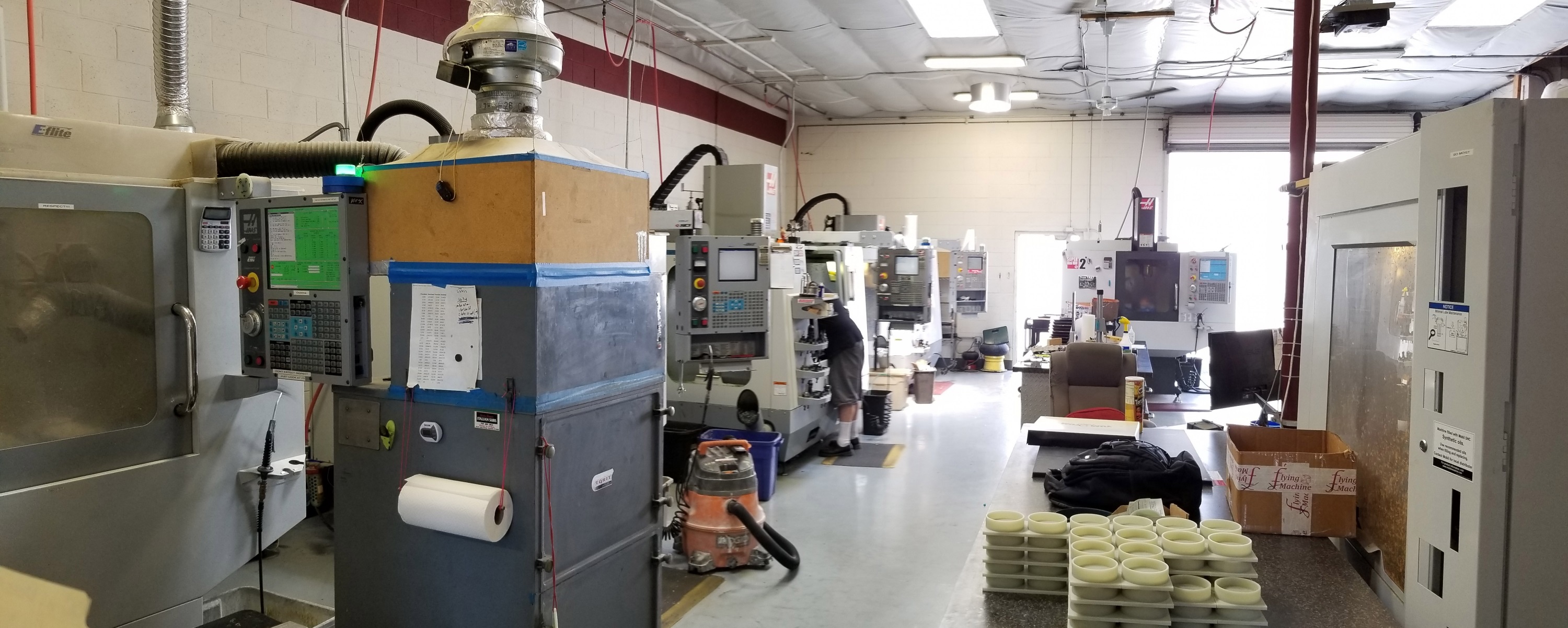

Hegemann is the president of Flying J Machine, an Escondido, Calif., machine shop and specialty manufacturing company. He’s been in business since 2000, has nine employees, nearly 8,000 sq. ft. of floor space, and a variety of modern equipment. This includes several Haas CNC machining centers and lathes, a Mitsubishi wire EDM, laser cutting equipment, and a small hole EDM machine. Much of his work is oceanographic in nature—instruments that measure water properties, mostly—but Flying J also has customers in the semiconductor, communications, and defense industries.

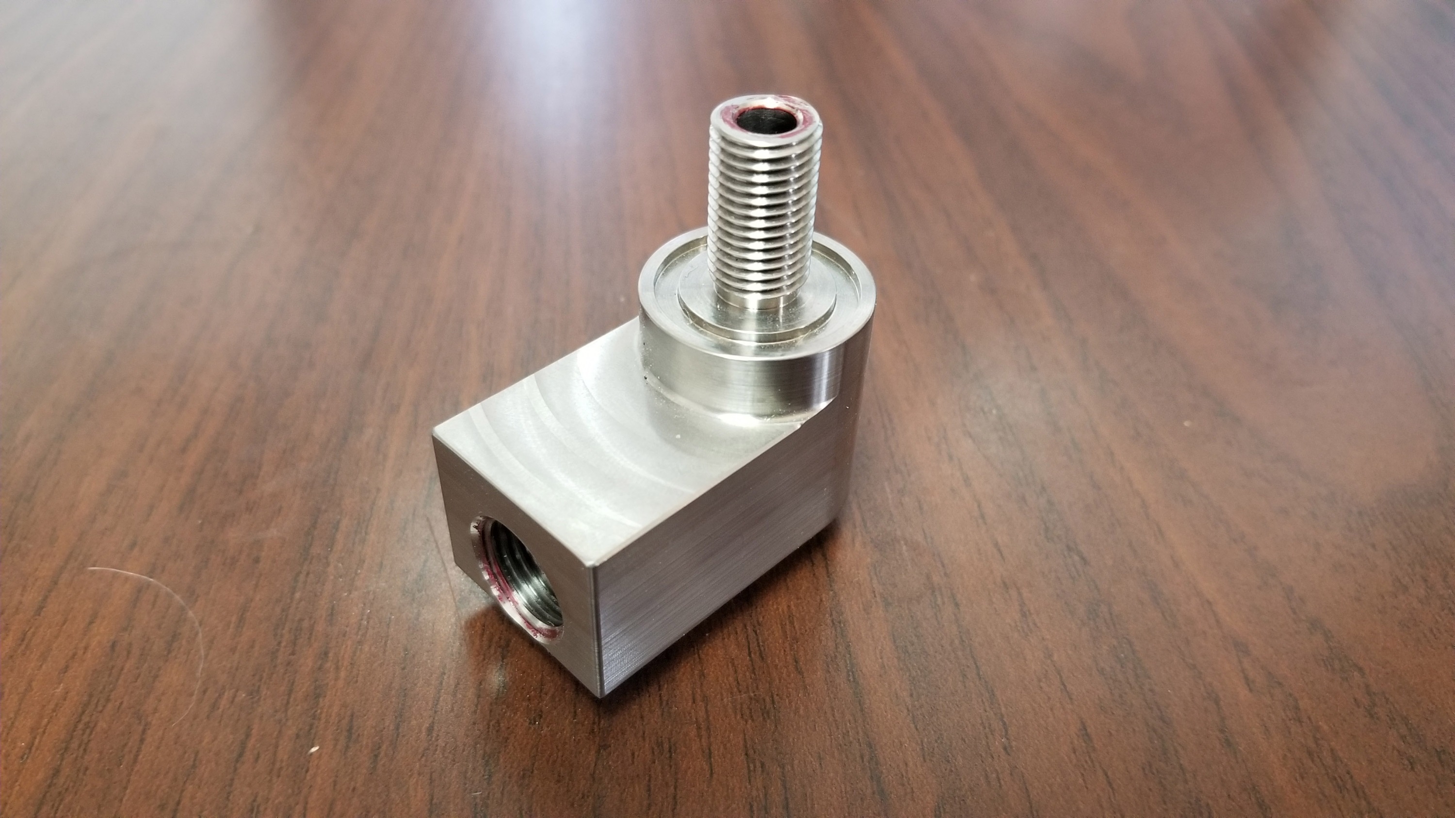

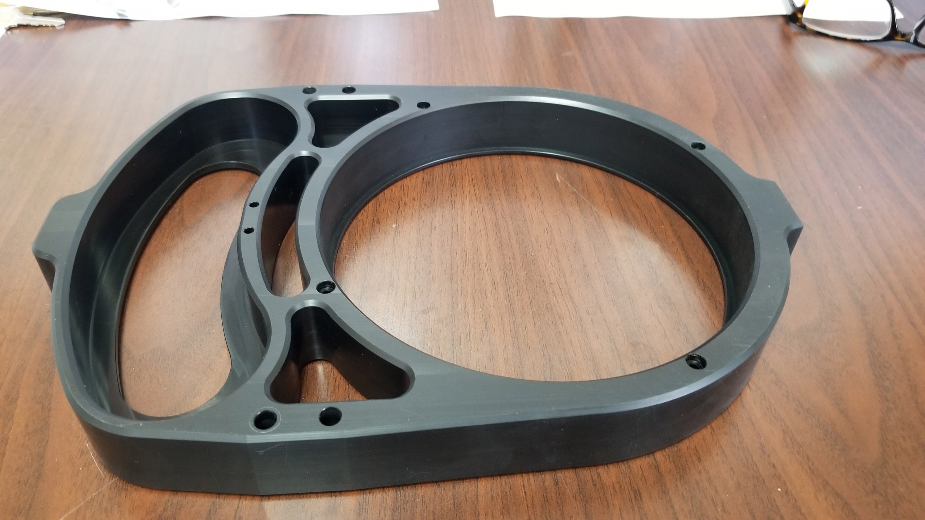

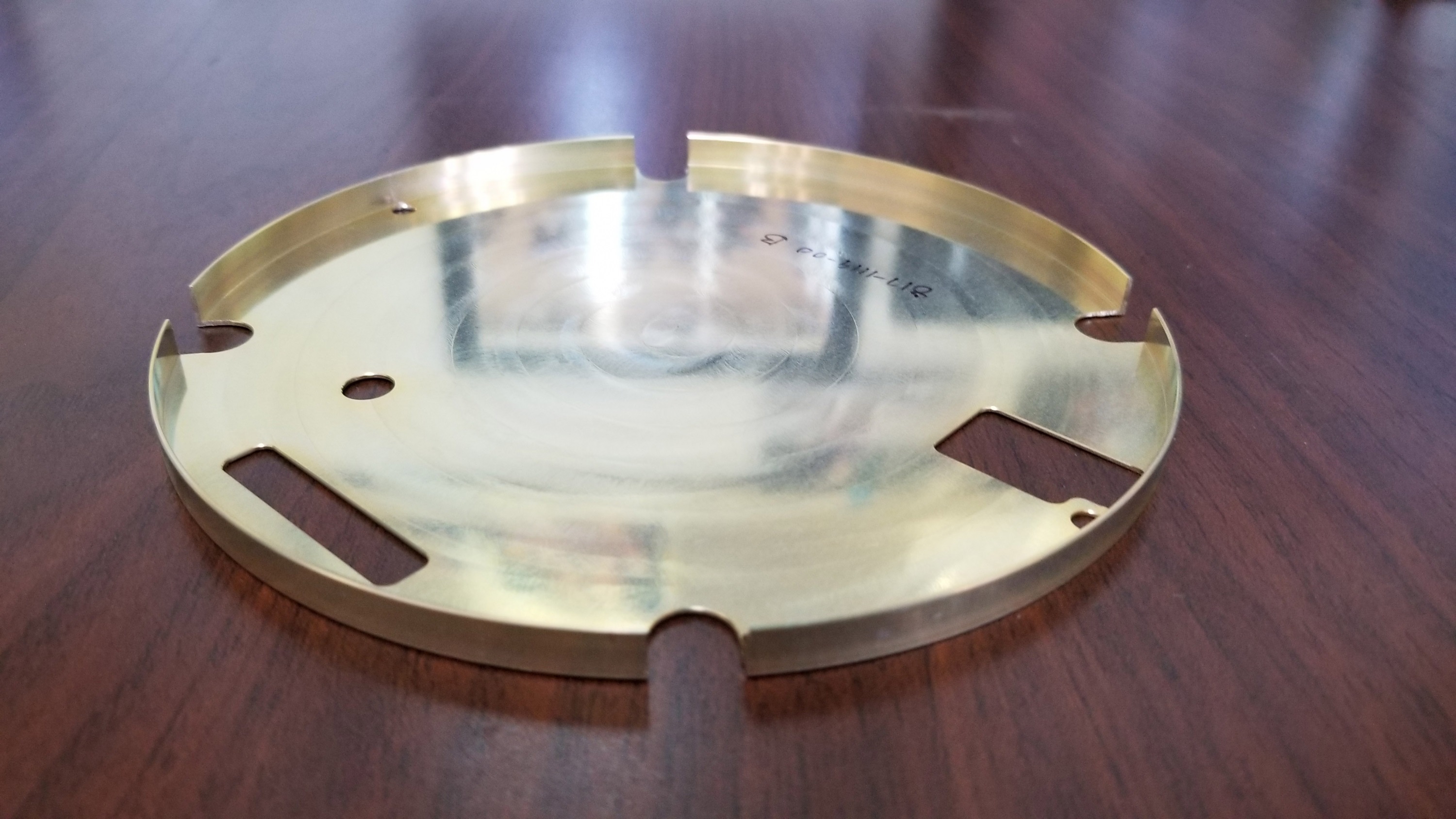

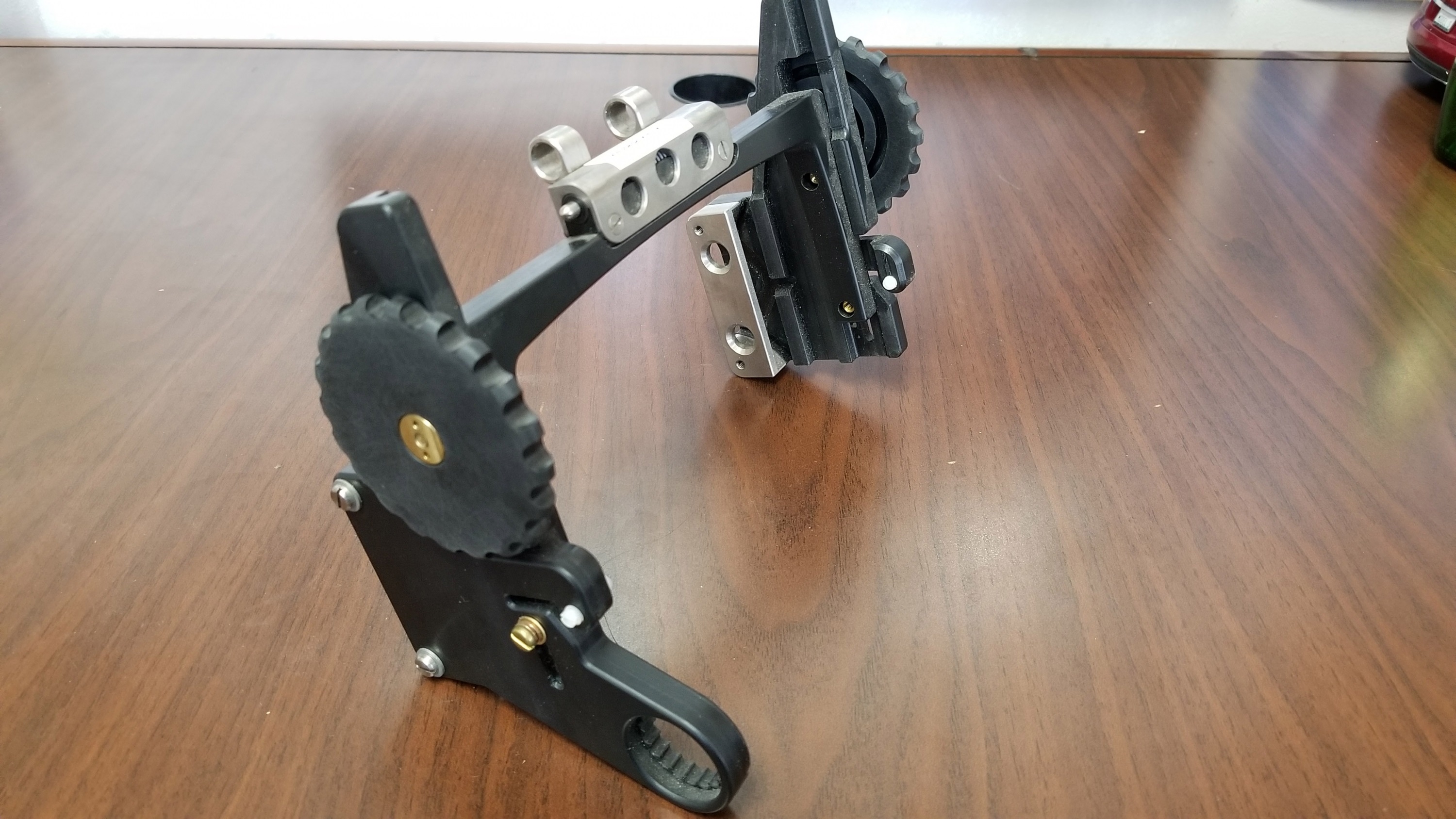

Some of the parts Flying J Machine produces. Photos courtesy of Flying J Machine

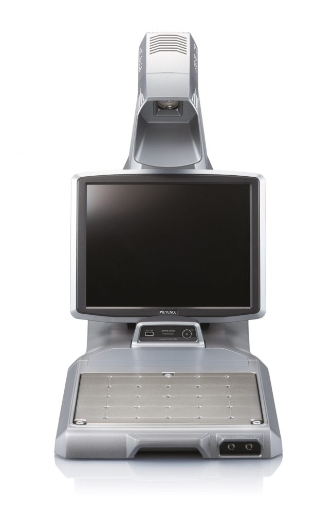

Hegemann says he wanted a piece of measuring equipment that anyone could walk up and use, without the need for complicated programming and extensive training. So when Keyence’s local XM specialist brought the system in for a demonstration, Hegemann knew a good thing when he saw it. “The writing was on thewall,” he says. “The XM is fast, accurate and easy to use. I ordered one that day.”
The Keyence XM series CMM is small enough to fit on a bench, but thanks to its movable stage and handheld probe, it can even measure large and complex parts. It has a simple user interface with an extensive, but easy to understand list of measurement options. Tools such as lines, points, circles, and planes are displayed on the screen, walking the user through the measuring process while providing GD&T functionality, virtual figures, statistics and trend analyses, deviation display and other advanced features.
Hegemann says the XM is simple enough to use that they skipped the offered training and got right to work—everyone in the shop has since been able to check their own parts with just a few minutes of instruction. “It’s so much better than our CMM,” he says. “You just walk up, click on the appropriate icon, and you measure a bore, distance between holes, flatness, whatever. I can’t really say how much time it saves, because it’s more a case of something that is actually being used compared to something that’s not being used.”
