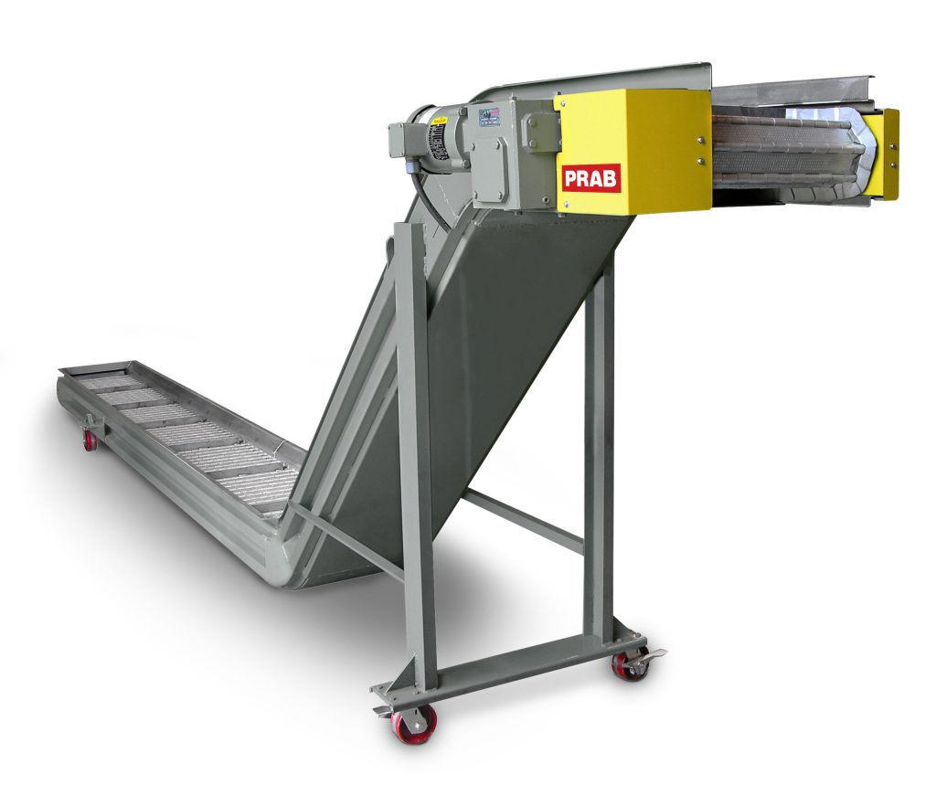

The simplest solution is a steel belt conveyor, which is used in these applications with some regularity.
Whitepaper: How to automate chip removal with the right conveyor image
A steel-belt conveyor handles most types of metal scrap. Photos courtesy of PRAB
More versatile than other types of material handling equipment, the steel belt conveyor can handle most types of wet or dry metal scrap – from bushy material to chips and turnings – in any volume, and in a wide variety of conveyor paths.
A hinged steel belt is the industry standard, but different types of belts can be used in these conveyors depending on the application, including:
Beaded Pan – for high heat and heavy wear applications
Pivot Belt – for small, thin chips and sticky scrap
Bucket Belt – for conveying highly flowable product up a steep incline
Steel belt conveyors can move a high volume of material consistently, even in piles and high surges, but they aren’t the best solution for dealing with high volumes of liquid flow. They also have a lot of moving parts that wear quickly and require maintenance when chips and fine particulate enter the mechanism.

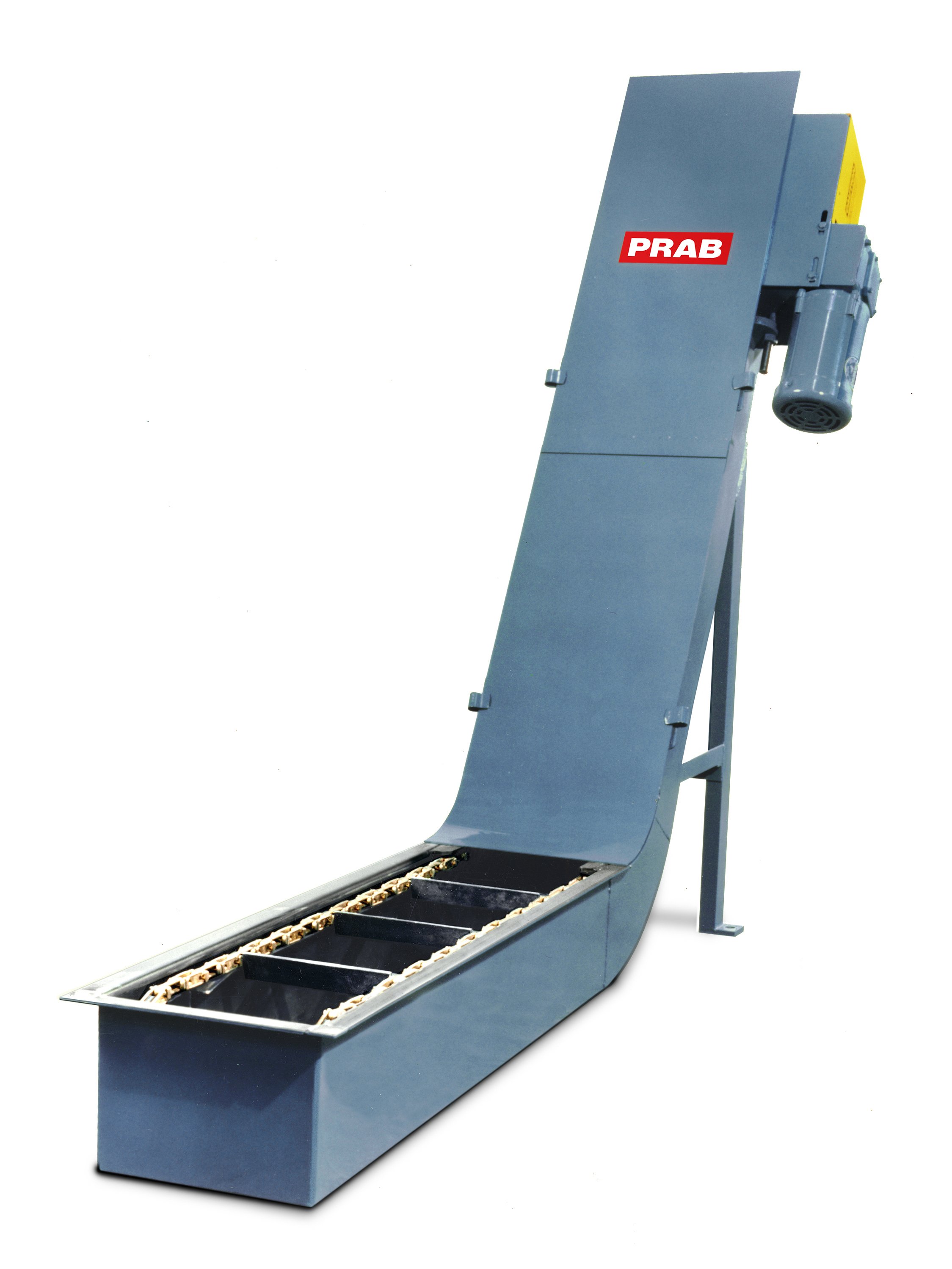

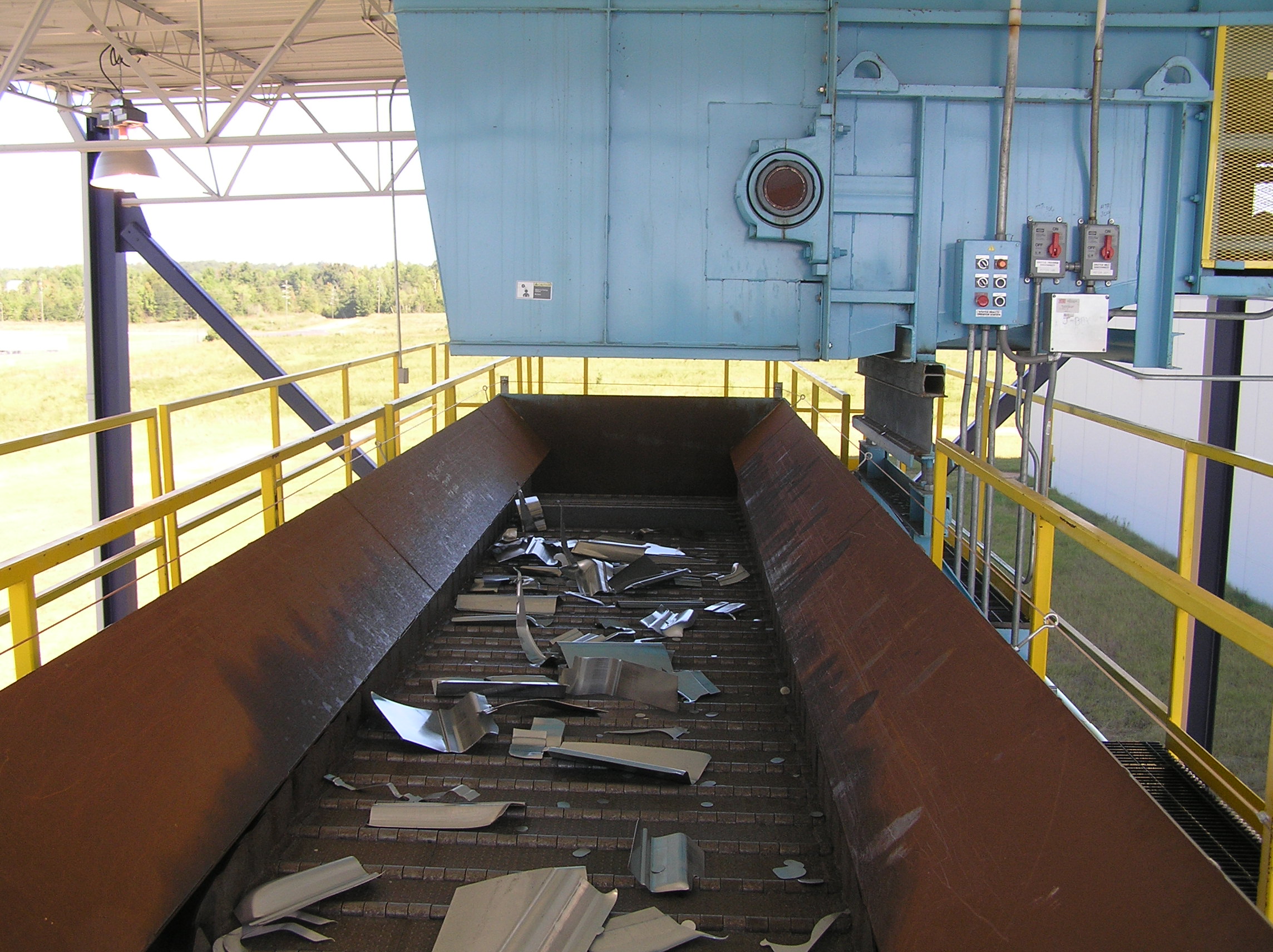

The next option is a drag conveyor, designed for conveying and elevating the most difficult, most abrasive, wet or dry materials in severe-duty situations. These conveyors can be installed at floor level for easy transfer of material from the machine table to the conveyor. They also feature multiple infeed and discharge points to fit specific applications, and they can be customized with coolant pumps for integration with a chip and fluid filtration system.
A drag conveyor is suitable for severe-duty situations.
Compared to steel belt conveyors, drag conveyors can handle a higher volume of coolant, and they have fewer moving parts to deliver more consistent material flow as opposed to surge loading. They are not ideal for processes that send cutoffs, bar ends, tooling pieces and other solid materials or parts through the conveyor, and they are not conducive to moving longer, stringier drill chips or turnings that can twist up and bundle.

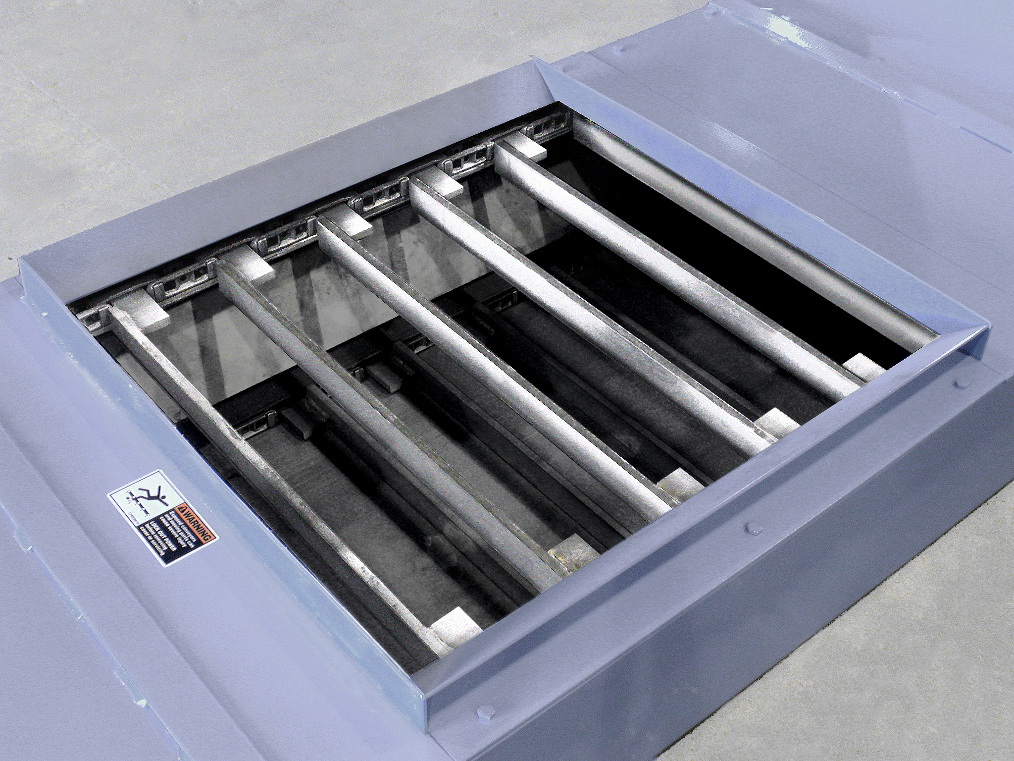

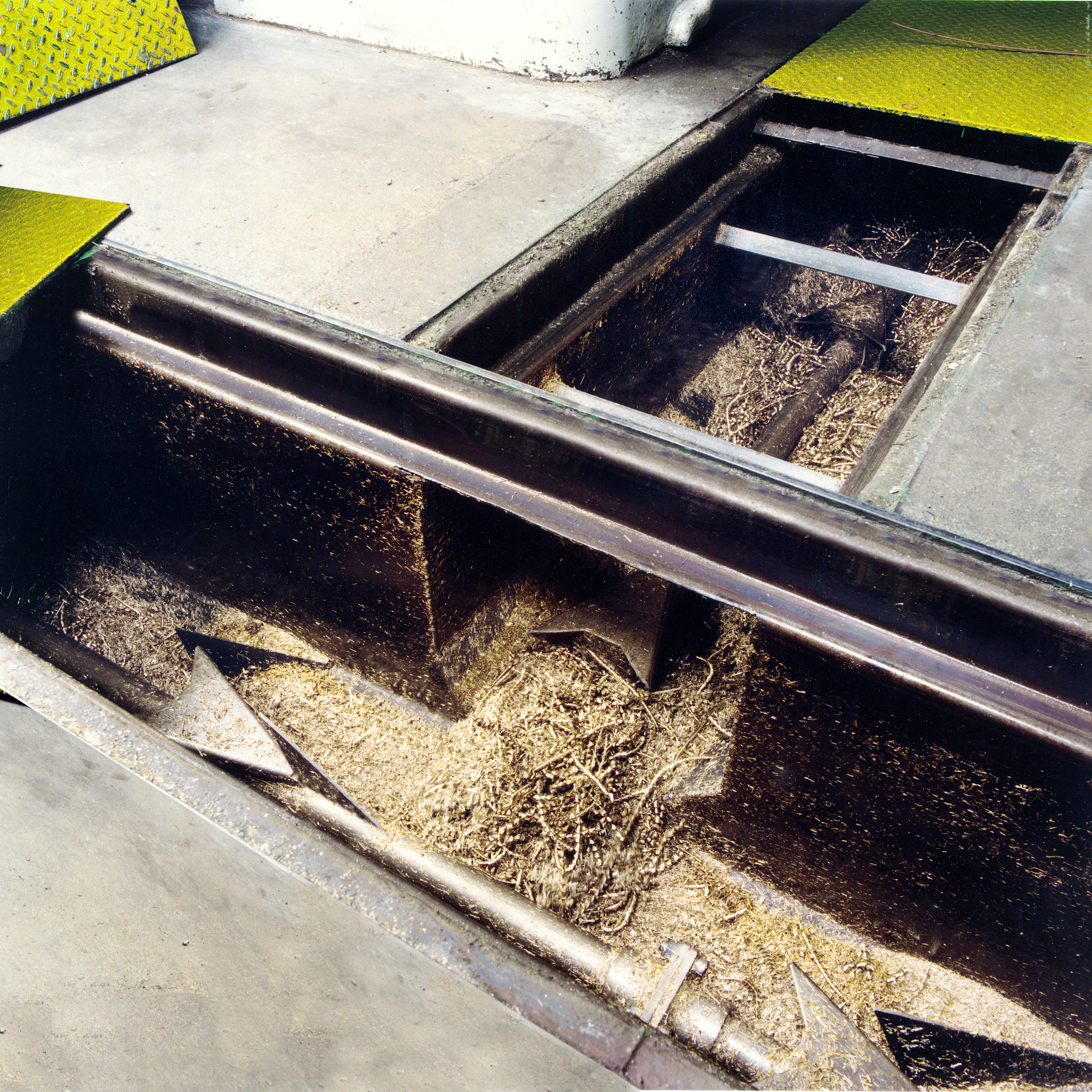

Trough-type conveyors are workhorses that transfer all types of metal chips, fines and turnings, wet or dry bushy wads, and tramp metal solids with time- and energy-saving efficiency. Their liquid-tight trough construction makes them ideal for high-volume coolant flow applications, and their flush-with-the-floor orientation allows both material and coolant to run directly into the conveyor with minimal manual interaction or slowdown of the process.
These conveyors are available in two types, each a reciprocating ram type of conveyor. A Harpoon trough conveyor has a ram assembly that floats in the trough and reciprocates back and forth. These troughs can collect high volumes of turnings, chips, stringies and as much fluid as is required. They can even pass small chunks of solid material that end up in the trough.
While this conveyance method is a little slower than others, a Harpoon trough can move a higher volume of material, so it can accomplish the same results as a faster-moving conveyor. Component wear can be a concern with these conveyors due to metal-on-metal contact on the bottom of the trough as the ram assembly reciprocates.
To combat this issue, the Push-Bar trough conveyor was developed. In this type of conveyor, the ram assembly is mounted on a bushing and rail system that lifts it off the bottom of the trough. This allows fluid and fine particulate to flow through the conveyor along the bottom of the trough without the excess wear.
In applications where there is a lot of fine particulate moving through the conveyor, the Harpoon system may be preferable because it scrapes along the bottom of the trough and will do a more thorough job of cleaning out the particulate. In a Push-Bar system, because the ram assembly is suspended slightly above the bottom of the trough, there will always be some amount of material there.
