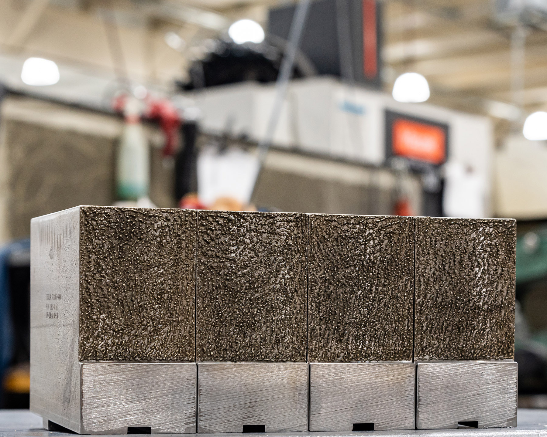

Carbinite Coating
In clamping tests, Carbinite has been shown to nearly double the gripping strength at equal clamping force. Customers report increased grip and longer tool life. Utilizing a process called Electro Spark Deposition (ESD), Carbinite can be added to hard or soft jaws after they are milled to customer requirements. The wear resistant carbide alloys display exceptional bond strength without annealing or distortion.

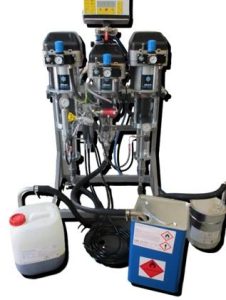

System for Corrosion Protection Coatings
The system allows a high coating speed. The coating medium can also be changed in a very short time, thanks to the system's automated cleaning process for all system components carrying operating supplies.
