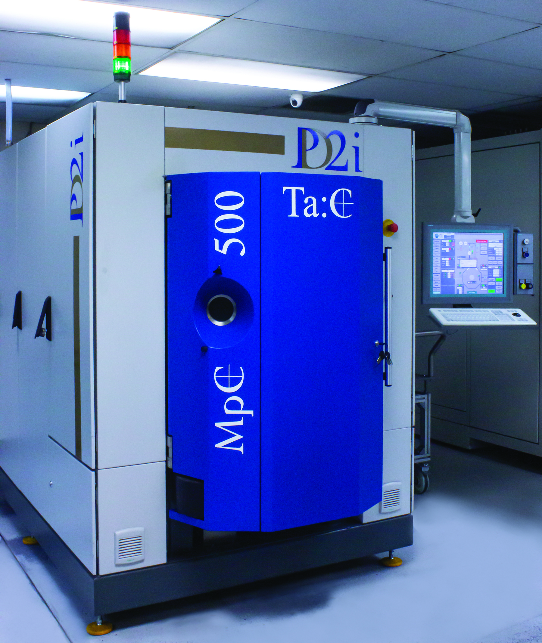

This PVD coating machine is part of a turnkey coating center, which includes cleaning, honing and inspection stations. Image courtesy of Precision Cutting Tools and PD2i
“You definitely have to dedicate personnel to it,” Sheth said, “because it takes time to clean the product, fixture the product and then un-fixture the product.”
