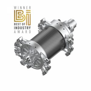

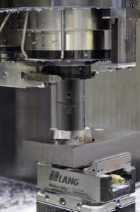

Stator Bore Tool
Machining three diameters in one operation, the stator bore tool ensures the alignment and concentricity of the machined surfaces whilst reducing the cycle time significantly. The lightweight 3D printed combination tool enables a faster tool change and spin-up even on less powerful machines. The surface specifications and component tolerances are achieved without constraints.n

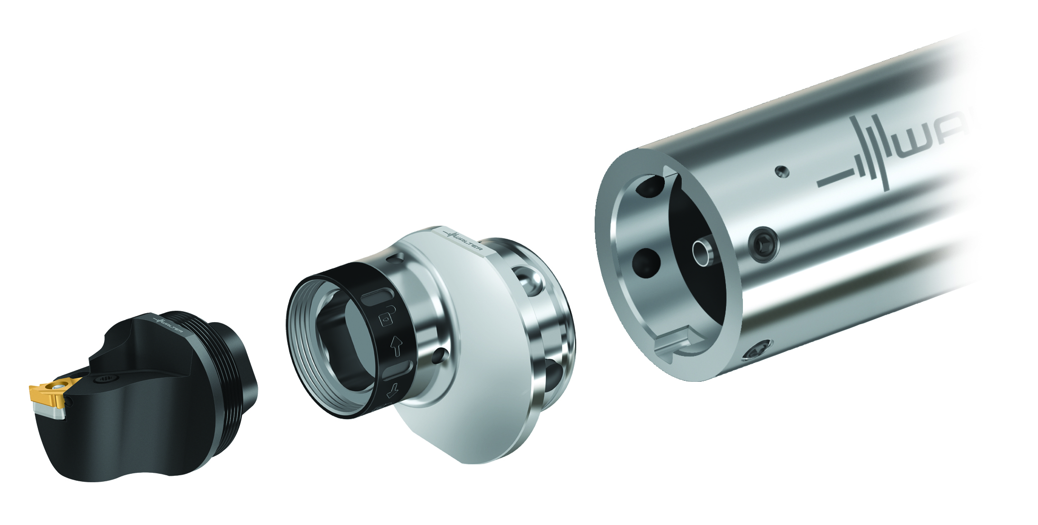

Accure-tec Anti-Vibration Boring Bar
The standard A2201 is an offset adaptor for reduced radial forces, greater stability and provides more space between the boring bar and the bore wall for improved chip removal with very deep bores. With the A3001 and the A2201 Walter has increased boring bar diameters to 2.5-4-in. and 60-100 mm.

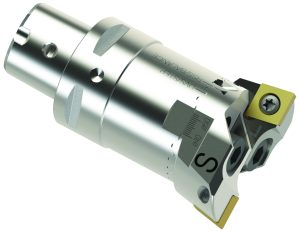

465 (464) Series of Fine Boring Heads
The 465 (464) fine boring heads have a full diameter range of 1.968" – 8.070" (50mm – 205mm) with the lightweight aluminum Alu-Line boring heads ranging from 2.559" – 8.070" (65.00mm – 205.00mm). Featuring the standard Wohlhaupter MVS connection, these boring heads provide the capability to adapt to any machine.

3D Printed PCD Monoblock Tool Bodies and Chip Deflectors
With 3D printing, there is about a 30% reduction in tool weight, yet it has the equivalent torsional stiffness of a steel ground body tool. Lightweighting can play a big role in large, heavy tools that take a toll on the machine spindle, helping to reduce preventative maintenance. These improvements can be significant when producing aerospace and automotive components, including electric vehicle parts, where existing spindle interfaces are not always ideal for some of the size/weight of tools.

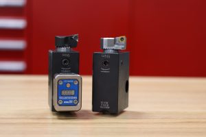

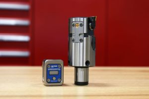

538 (537) Boring Cassette with 3ETECH Digital Display
Made of hardened steel, it is extremely robust and resistant to all external mechanical influences. It can be used on serrated tool bodies and Alu-Line slide tools in the diameter range from 3.937" – 128.15" (100 mm – 3255 mm). Additionally, this precision boring tool can be adjusted without the aid of the readout. Its diameter can be set via a vernier scale in 0.0001" (0.002 mm) increments. This new tool offers an excellent price/performance ratio with extreme accuracy and strength in any industry.

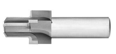

IS0 1179 Port Tools
Smaller thread size port tools are three flutes and larger thread size port tools are four flutes. 1179 port tools have a polished flute face for the best performance. Items are stocked uncoated or AlTiN coated. AlTiN coating is highly recommended if cutting steel as the coating prevents the chip from sticking to the carbide. Additionally, AlTiN coating improves tool life and allows the tool to achieve a high-quality finish.

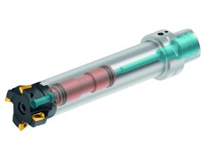

Accure·tec AC001 Vibration Damping Adaptor
Accure·tec adaptors are ideally suited for the Walter Xtra·Tec® XT milling cutter range. This makes the system highly versatile. For example, for components with deep cavities in aircraft construction and aerospace industry in general, as well as the automotive, energy, die/mold, and general metalworking industries. Users can benefit from both the vibration damping and a system with low noise levels. n

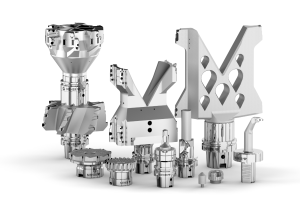

Wohlhaupter VolCut Insert Holder
VolCut combines the benefits of the modularity of the Wohlhaupter MVS connection with Allied Machine and Engineering's large diameter holemaking solution. This time-saving combination offers increased material removal and excellent chip control at greater depths for large diameter applications - even on underpowered machines. The VolCut insert holder is stocked for quick delivery with bore diameters ranging from 2.559" – 128.149" (65mm – 3255mm). Its unique designincorporates serrations designated to connect seamlessly with Wohlhaupter's Twin Cutter and AluLine boring systems.
