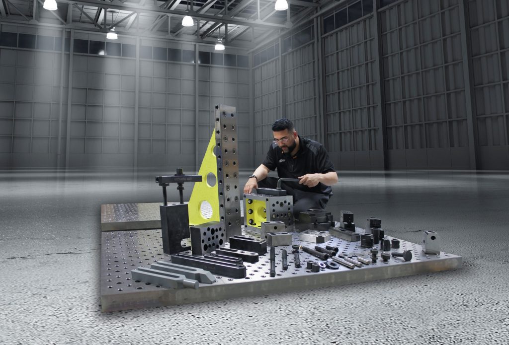

Bluco Corporation today announced the official release of a modular fixturing system designed to hold extra-large parts for CNC machining. The system is the company’s largest modular fixturing solution to date, and the first complete line of its kind. The official name for the system is the 8024 Modular Fixturing Series, which designates 80mm grid spacing and 24mm nominal bore size.
Bluco’s application engineers will use the new 8024 series to design custom solutions that raise the bar on fixture performance for manufacturers of large parts. The system delivers repeatable precision without the need for additional tramming and locating after installation, as well as a host of other benefits.

In part, this efficiency is made possible by the baseplate that’s part of every solution. “We customize a modular baseplate to fit each customers machine bed,” says Gordon. “So instead of bolting a part directly to the machine bed, where you’re only guaranteed accuracy in one axis or direction, now you’re bolting to a plate that will give you accuracy down to thousandths of an inch in every direction. Obviously, that makes a big difference both in machine efficiency and final part quality.”
Superior Accuracy & Improved Functionality
Bluco’s engineering team went through an extensive research and development process in order to design each component, and an even more rigorous quality control procedure on the back-end. The result is a system that delivers a combination of advantages that haven’t been available to manufacturers of large parts in the past:
Accuracy: +/- 0.015mm (+/- 0.0006″)
Quality: Precision-ground components
Rigidity: Heavy pieces allow reliable clamping against a single component
Flexibility: One kit of extra-large modular components can be used to fixture multiple parts
Efficiency: Larger parts mean less components and faster fixture building.
