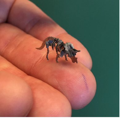

The Finecut micro abrasive waterjet system brings the benefits of waterjet technology to the high precision fine mechanic segment. The Finecut is a premium precision machine with a positioning accuracy of +/-2.5 microns. It can cut minute parts of high complexity with a miniaturized cutting system capable of jet diameters down to 200 microns. Nevertheless, it can as well be used to cut high precision features into large parts up to 500 by 500 mm size, using the full work envelope.

The particle erosion process nimbly adopts to the material and cuts complex shapes out of virtually all materials without thermal nor mechanical damage. The adaptability is specifically advantageous for composites and combined/sandwiched materials that are easily cut with the same tool.
