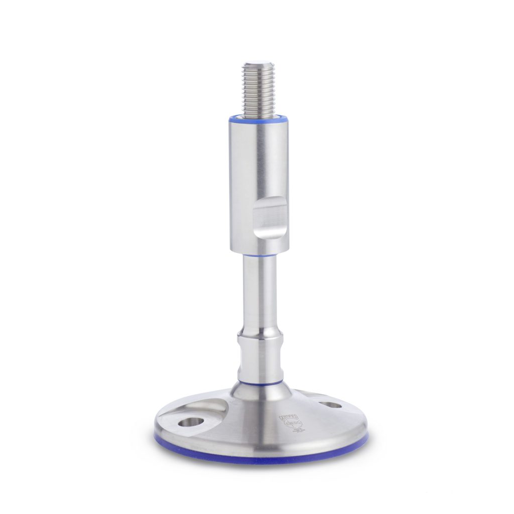

These hygienic leveling feet with mounting holes are certified according to European Hygienic Engineering and Design Group guidelines, making them ideal for use in hygienic applications, as the bottom seal protects the area beneath the foot plate from dirt.
For this, the foot must be screwed on using the mounting holes and compressed accordingly. The sealing ring above the adjustment sleeve enables fastening without dead space. Due to the wiper or the ball seal, the moving components are sealed against the environment, while the finish prevents adherence of dirt and facilitates cleaning.
