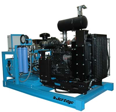

Waterjet manufacturer Jet Edge Inc., introduces the 80-hp, 60,000-psi iP60-80DS diesel-powered, waterjet intensifier pump.
August 1, 2010
Waterjet manufacturer Jet Edge Inc., introduces the 80-hp, 60,000-psi iP60-80DS diesel-powered, waterjet intensifier pump. The iP60-80DS waterjet pump is capable of producing up to 1.35 gpm (5.1 L/m) of high-pressure water for mobile water jet cutting applications, and is especially suited for cold cutting in environments where heat and flames are restricted. Built with the contractor in mind, the iP60-80DS is powered by a four-cylinder Cummins turbocharged diesel engine and is designed for portability and ease of maintenance. Intensifier components can be accessed without having to get into the hydraulic center section and hydraulic rod seal. No special tools are required.
