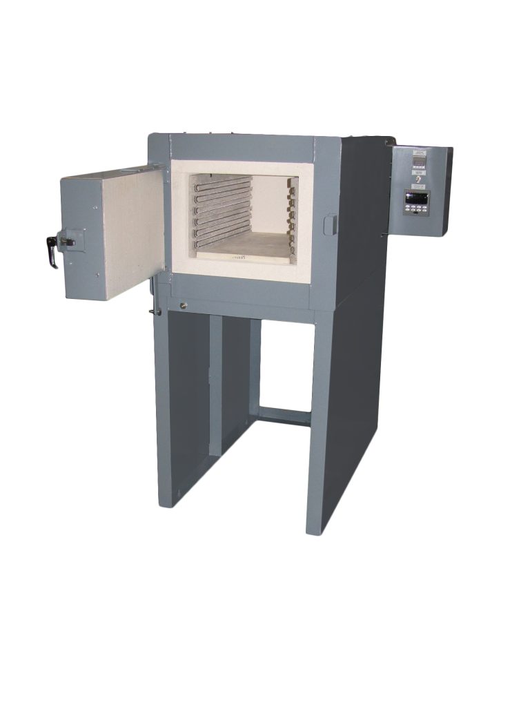

Century Die Company LLC, a blow mold specialist in Fremont Ohio, has added to their heat treating capability with a Lucifer Red Devil single-chamber furnace. Model RD7-H21 has a working chamber size of 9"H x 12"L by 21"D and heats to 2200° F.

Energy efficient lightweight firebrick lines the chamber with mineral wool backup insulation; easy-to-replace heating elements for uniform radiation are situated along both side walls. The Red Devil box furnace series comes standard with a horizontal swing door and safety microswitch as well as a ceramic hearth plate to support the workload and protect the floor brick insulation.
Century Die chose to accessorize their furnace with a base stand to bring the hearth height to 30". The upgraded Honeywell UDC 2500 controller allows programming up to 12 segments. An additional soak timer with alarm contact alerts the operator when heat treating is complete.
