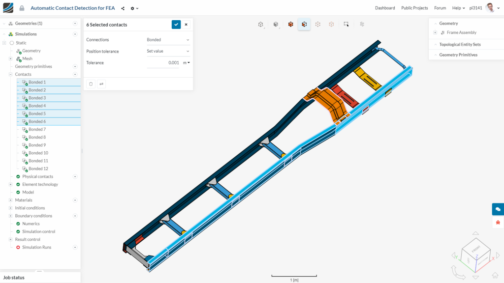

While finite element analyses on CAD assemblies have been possible with SimScale before, a better way of properly constraining a model is a requirement that has been requested by many users. Moving away from manually having to define contacts, the online simulation platform can now automatically detect contacts between parts of an assembly, saving time and improving the user’s experience. The feature is already available and can be used for all finite element analysis types—static, dynamic, heat transfer, thermomechanical and frequency analysis.
Automatic contact detection will be triggered automatically whenever a new multiple-part geometry is assigned to a simulation. By default, all contacts in the assembly will always be created as bonded contacts, and can then be edited by the user. The possibility of manually triggering contact detection is also available. Once completed, all detected contacts are grouped to create a constrained system. In addition, a newly added feature makes it possible to convert one or multiple contacts into a physical/nonlinear contact.
