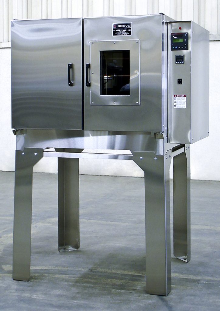

No. 1017 High-Temperature Bench Oven
No. 1017 is a 1,000º F high-temperature bench oven from Grieve used for various heat processings at the customer's facility. Workspace dimensions of this oven measure 22" W x 22" D x 13" H, and 3kW are installed in Incoloy-sheathed tubular elements to heat the oven chamber, while a recirculating blower provides airflow to the workload.
October 19, 2018
No. 1017 is a 1,000º F high-temperature bench oven from Grieve used for various heat processings at the customer’s facility. Workspace dimensions of this oven measure 22″ W x 22″ D x 13″ H, and 3kW are installed in Incoloy-sheathed tubular elements to heat the oven chamber, while a recirculating blower provides airflow to the workload.
This Grieve bench oven features 5″ insulated walls, stainless steel exterior with #4 brushed finish, Type 304, 3B finish stainless steel interior, integral oven stand and an 8″ x 10″ double-pane Pyrex/Vycor viewing window.
Controls onboard No. 1017 include a digital programming temperature controller and manual reset excess temperature controller with separate control contactors.
