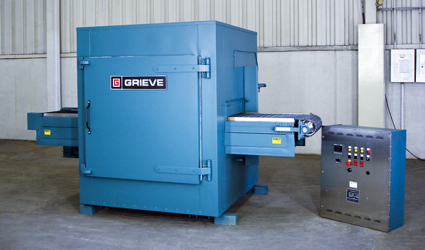

No. 1021 is a 1250º F high-temperature belt conveyor oven from Grieve, currently used for drying steel nesh (sieve) materials at the customer's facility. Workspace dimensions of this oven measure 21" W x 38" D x 3" H, and 40 KW are installed in Incoloy-sheathed tubular elements to heat the oven chamber, while a 1600-cfm, 1.5-hp recirculating blower provides vertical downward airflow to the workload.
December 27, 2018
No. 1021 is a 1250º F high-temperature belt conveyor oven from Grieve, currently used for drying steel nesh (sieve) materials at the customer’s facility. Workspace dimensions of this oven measure 21″ W x 38″ D x 3″ H, and 40 KW are installed in Incoloy-sheathed tubular elements to heat the oven chamber, while a 1600-cfm, 1.5-hp recirculating blower provides vertical downward airflow to the workload.
This Grieve packaged conveyor oven features 10″ thick insulated walls made from 8″ of 1900º F block and 2″ of 10 lb/cf density rockwool insulation, aluminized steel exterior, Type 304, 2B finish stainless steel interior and an 18″ wide, 1″ x 1″ stainless steel flat wire conveyor belt with 1/3-hp motor drive, variable from 0.05 to 1.20 feet per minute. The oven travel comprises a 30″ long open belt loading zone, 38″ long insulated heat zone with recirculated airflow and 30″ long open unloading zone. 10″ x 10″ stainless steel mesh screens above the return ductwork below the conveyor are provided to collect debris from the workload.
Controls onboard No. 1021 include a digital indicating temperature controller, SCR power controller and wall mounted remote control panel (shown detached in photo).
