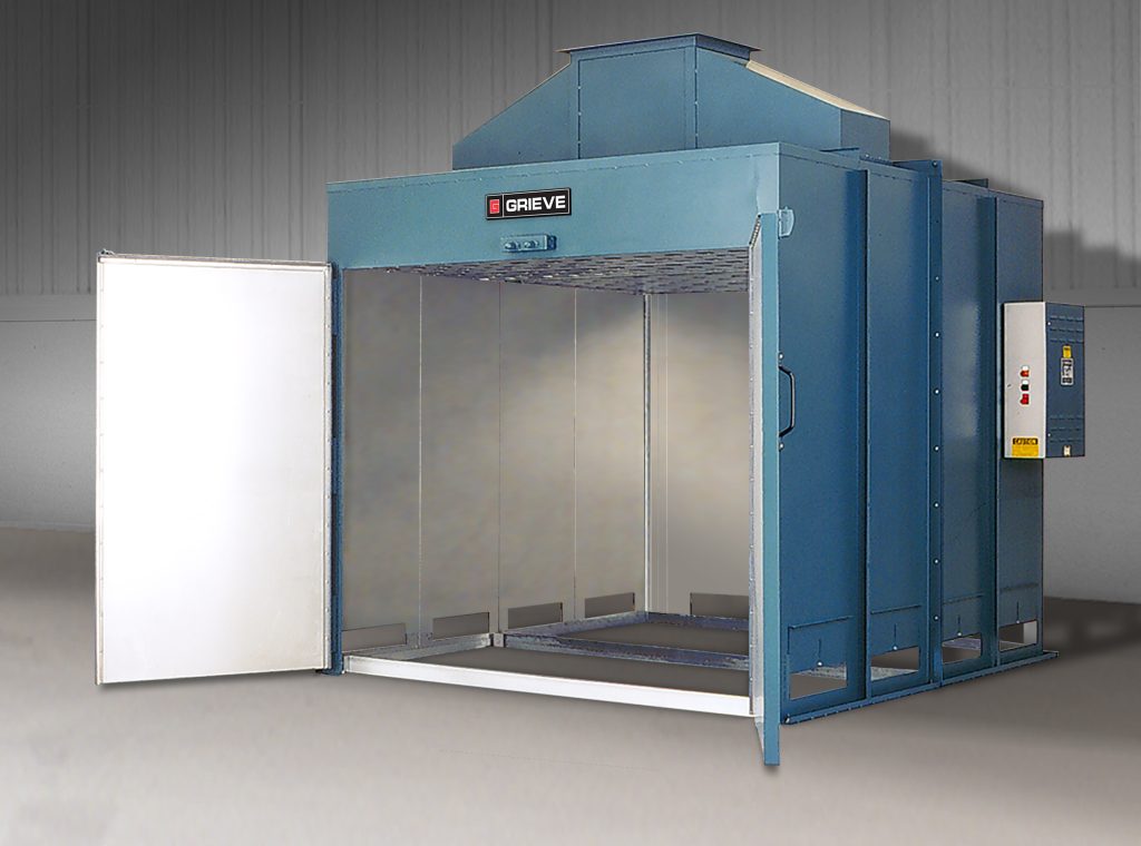

No. 807 is a cooling chamber from Grieve, currently used for cooling oven trucks of steel parts at the customer's facility. Workspace dimensions of this cooling chamber measure 84" W x 96" D x 72" H. 7,000-cfm, 7.5-hp, remote-mounted exhaust blower is used to pull room air through load and exhaust.
March 19, 2019
No. 807 is a cooling chamber from Grieve, currently used for cooling oven trucks of steel parts at the customer’s facility. Workspace dimensions of this cooling chamber measure 84″ W x 96″ D x 72″ H. A 7,000-cfm, 7.5-hp, remote-mounted exhaust blower pulls room air through load and exhaust.
This Grieve cooling chamber has aluminized steel construction, ¼” plate floor and is sectioned to pass through a 72″-wide doorway.
No. 807 has twelve (12) 24″ x 24″ x 6″-thick HEPA filters installed at top of workspace to filter exhausted air.
