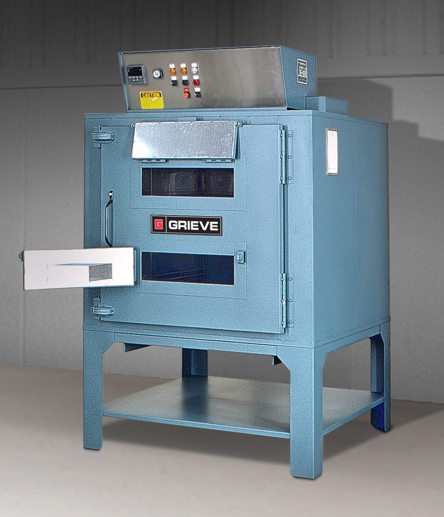

No. 824 is a 500° F (260° C) modified universal oven from Grieve, currently used for housing a vertical conveyor system at the customer's facility. 9 KW installed in Nichrome wire heating elements, while a 600-cfm, 1/2-hp recirculating blower provides universal airflow to the workload.
July 17, 2019
No. 824 is a 500° F (260° C) modified universal oven from Grieve, currently used for housing a vertical conveyor system at the customer’s facility. 9 KW installed in Nichrome wire heating elements, while a 600-cfm, 1/2-hp recirculating blower provides universal airflow to the workload.
This Grieve modified universal oven features 4″ insulated walls, aluminum steel exterior, Type 430 stainless steel interior and two 20″ wide x 5-1/2″ high conveyor access doors installed in oven door. Additional features include safety equipment for handling flammable solvents, including explosion venting door hardware. The oven also features an integral leg stand.
Controls on the No. 824 include a digital indicating temperature controller, manual reset excess temperature controller with separate contactors and recirculating blower airflow safety switch.
