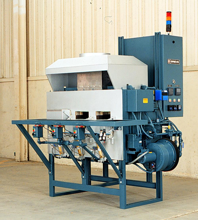

No. 875 is a gas-fired, 1600°F (about 871°C) specialty furnace from Grieve, currently used for burning off hydrocarbons from machined alloy components at the customer's facility.
March 13, 2013
No. 875 is a gas-fired, 1600°F (about 871°C) specialty furnace from Grieve, currently used for burning off hydrocarbons from machined alloy components at the customer’s facility. Three workspace stations are provided in this furnace, each measuring 10″ W x 10″ D x 2″ H. 500,000 BTU/HR are installed in a modulating natural gas burner to heat the unit. An exhaust hood is positioned over the flue, with a remote mounted 16″ dia. tubeaxial fan, driven by a ¾ HP motor.
This unique Grieve furnace features 5″ thick insulated walls throughout, comprising 2″ of 2300°F ceramic fiber and 3″ of 1900°F block insulation. In addition, 6-½” floor insulation is made from 4-½” of 2300°F firebrick and 2″ of 1900°F block insulation.
Three air-operated vertical lift doors seal the workspaces, while three independent timers are provided, each with a pilot light, audible alarm and safety door interlock, to individually time the process cycle in each furnace compartment. A tower light is onboard to indicate operational status.
No. 875 is built to JIC/NEMA 12 electrical standards.
