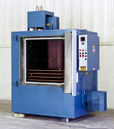

No. 887 is a gas-fired 1000°F cabinet oven from Grieve, currently used for curing metal coatings onto parts.
August 1, 2015
No. 887 is a gas-fired 1000°F cabinet oven from Grieve, currently used for curing metal coatings onto parts. The unit’s workspace dimensions measure 38″W x 38″D x 38″H. 175,000 BTU/HR installed in a modulating natural gas burner provide heat, while a 2,000 CFM, 2-HP stainless steel recirculating blower furnishes a horizontal airflow across the workload.
This cabinet oven features an aluminized steel exterior, Type 304, 2B finish stainless steel interior, plus inner and outer door gaskets which seal against the door plug and the front face of the oven.
No. 887 has 8″ thick insulated oven walls, consisting of 2″ of 1900°F block and 6″ of 10 lb/cf density rockwool insulation.
All safety equipment is onboard as required by IRI, FM and NFPA Standard 86 for gas-heated equipment, including a 325 CFM, 1⁄3-HP powered forced exhauster.
A digital indicating temperature controller is also provided.
