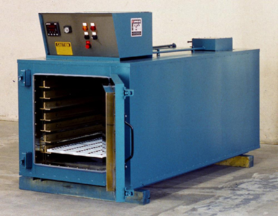

No. 891 is a specially modified 500°F electric universal oven from Grieve. It is currently used for heating tool cassettes at a customer’s facility. Workspace dimensions of this unit measure 24″W x 60″D x 24″H.
Providing the heat is 6.6 kW installed in Nichrome wire heating elements, while a 600 CFM, 13-HP recirculating blower furnishes a universal pattern airflow to the workload.
This oven features an aluminized steel exterior, Type 430 stainless steel interior and 4″ thick insulated walls, plus a silicone rubber door gasket and explosion-venting latches. A 500 lb. capacity subway grating shelf and seven angle iron shelf supports are included.
No. 891 has a digital indicating temperature controller to display actual and set point readings.
